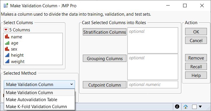

Launch the Make Validation Column PlatformLaunch the Make Validation Column platform by selecting Analyze > Predictive Modeling > Make Validation Column.
Figure 12.3 Make Validation Column Launch Window
The Make Validation Column launch window provides the following options:
Stratification Columns
Assigns one or more stratification columns.
Grouping Columns
Assigns one or more categorical grouping columns.
Cutpoint Column
Assigns a numeric cutpoint column.
Cutpoint Batch ID
When a cutpoint column is assigned, you can also assign a column for cutpoint batch IDs. This enables you to determine cutpoint values within each level of the Cutpoint Batch ID column.
Provides three methods for validation.
creates a validation column based on the specified stratification, grouping, and cutpoint columns. The validation column method determined by the specified stratification, grouping, and cutpoint columns is described below the box. After a method is selected and you click OK, you specify the allocations for each set in the Make Validation Column report. See Specify Rates or Relative Rates and Set Cutpoints. There are five methods for constructing the holdback sets. All of these methods, except for Cutpoint Validation, are also used to create the folds for K-Fold Validation. See Make K-Fold Validation Column.
