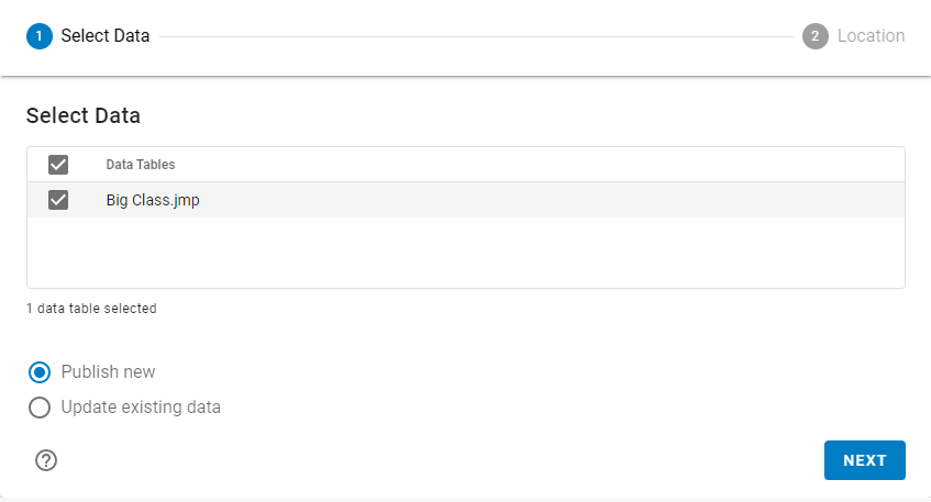

Figure 10.14 Select the Data
Select the Data
Tip: To choose all open data tables, select the Data Tables box.
3. Choose what you want to do:
– Publish a New Data Table
– Update an Existing Data Table
4. Click Next.

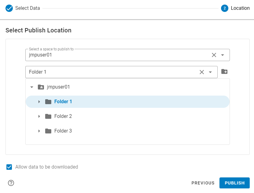

Figure 10.15 Select Where to Publish the Data
1. Select an existing space from the list or enter text to find a space that you want to publish your data to.
You see only spaces that you have permission to publish to.
2. (Optional) Select an existing folder from the list or enter text to find the folder where you want to publish your data.
Tip: To create a new folder, click the space or folder where you want to create the folder and click Create folder Image shown here.
3. Choose whether to allow users to download the data.
4. Click Publish.

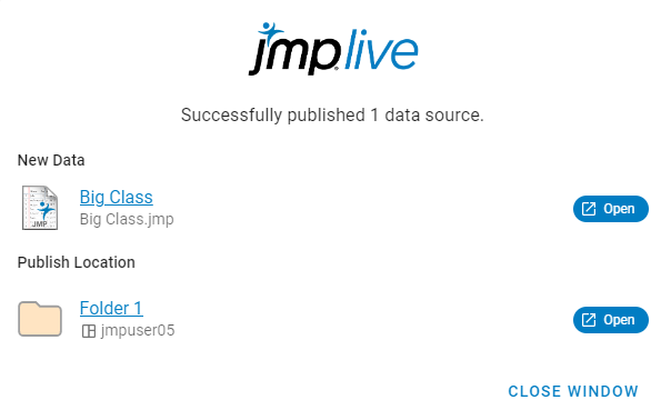

Figure 10.16 Publish Status for a New Data Table
5. Click an Open link to launch JMP Live, or click Close Window.

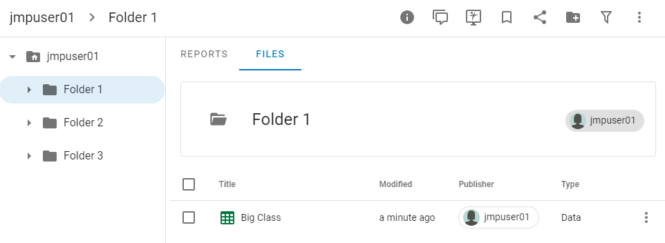

Figure 10.17 Published Data File in JMP Live
Space access determines who can see your data post. For details, see the JMP Live Help.

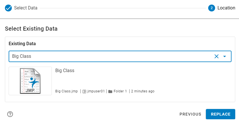

Figure 10.18 Select an Existing Data Table
Note: You see only data tables that you have permission to update.
1. Select an existing data table from the list or enter text to find a table.
2. Click Replace.

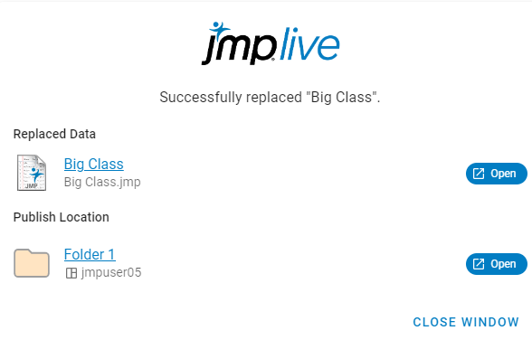

Figure 10.19 Publish Status for Updating a Data Table
3. Click a link to open JMP Live, or click Close Window.
