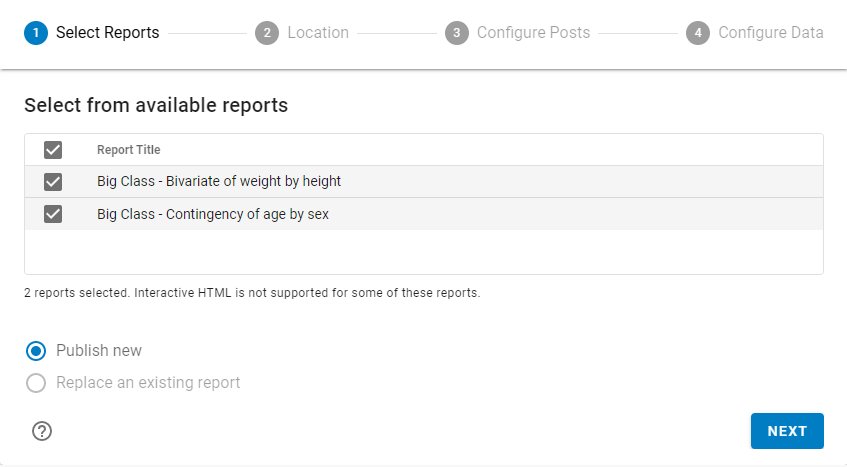

Figure 10.4 Select the Reports
Select the Reports
3. Select the reports that you want to publish.
Tip: To choose all open reports, select the Report Title box. If you are replacing a report, you can choose only one report.
4. Choose what you want to do:
– Publish a New Report
– Replace an Existing Report
5. Click Next.

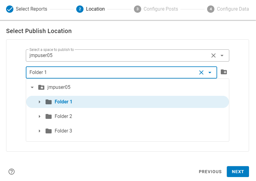

Figure 10.5 Select Where to Publish the Reports
1. Select an existing space from the list or enter text to find a space that you want to publish your report to.
You see only spaces that you have permission to publish to.
2. (Optional) Select an existing folder from the list or enter text to find the folder where you want to publish your report.
Tip: To create a new folder, click the space or folder where you want to create the folder and click Create folder Image shown here.
3. Click Next.

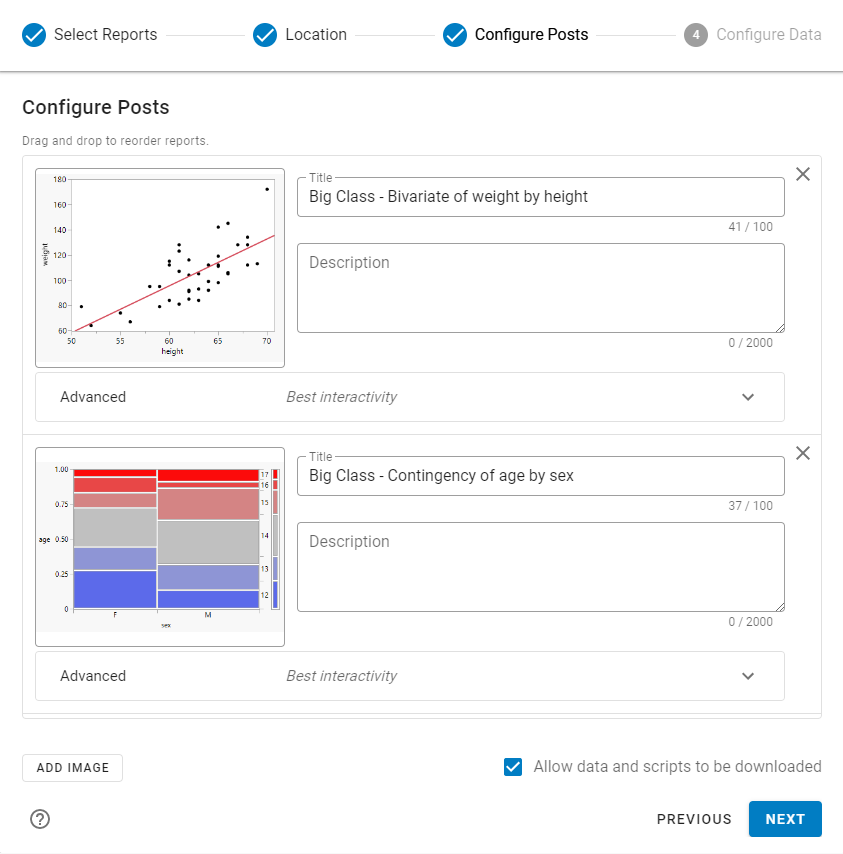

Figure 10.6 Update Report Options
4. (Optional) Update the title for each report.
5. Change additional options. See Report Options.
6. Click Next.

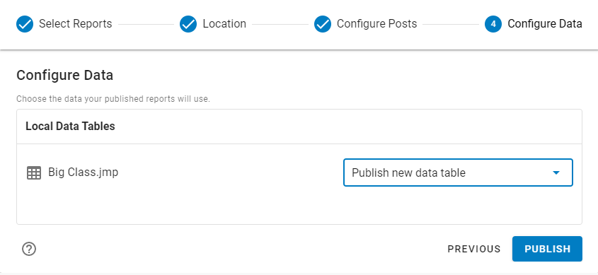

Figure 10.7 Update Data Options and Publish
7. Choose whether to publish a new data table or use an existing JMP Live data table.
8. Click Publish.

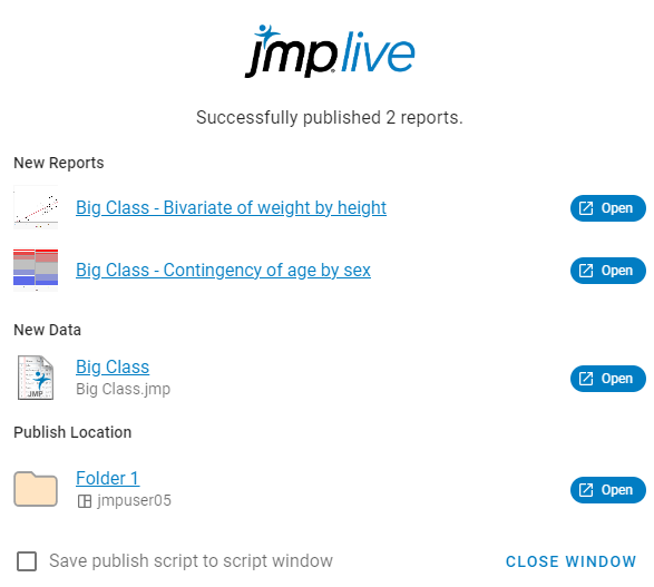

Figure 10.8 Publish Status for Creating a New Report
9. (Optional, JMP Live only) To save your process as a JSL script, select Save publish script to script window.
10. Click an Open link to launch JMP Live, or click Close Window.

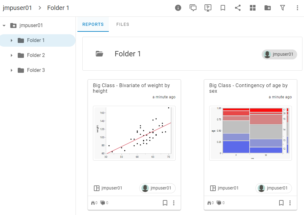

Figure 10.9 Published Reports in a JMP Live Folder
Space access determines who can see your report post. For details, see the JMP Live Help.

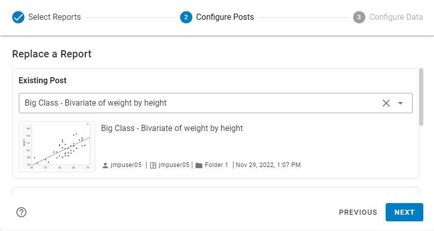

Figure 10.10 Select an Existing Post
Note: You see only posts that you have permission to update.
1. Select an existing post from the list or enter text to find a post.
2. Click Next.

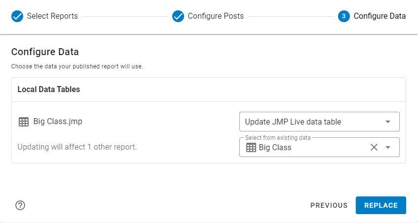

Figure 10.11 Choose How to Publish Data
3. (Publish data only) Choose an option:
– update the existing JMP Live data table
– publish new data to JMP Live
– use an existing JMP Live data table
If you choose to update or use existing JMP Live data, select a JMP Live data table.
Note: To use existing data, you must have permission to download the data.
4. Click Replace.

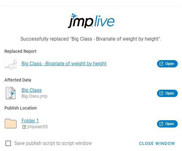

Figure 10.12 Publish Status for Replacing a Post
5. (Optional, JMP Live only) To save your process as a JSL script, select Save publish script to script window.
6. Click an Open link to launch JMP Live, or click Close Window.

Report Options
Description
(Optional) Add a description of the report that appears on the post’s thumbnail.
Advanced
Select Publish data for interactive reports. If you deselect this option, the reports are static. When selected, the data behind the report and a JSL script of the report are published.
Best interactivity
All supported aspects of the report are fully interactive.
Best performance
Images and graphs are not interactive, but supported data in the rest of the report remains interactive. If your data set is large, you might choose this option to increase the responsiveness of the report.
Tip: To avoid sharing sensitive data, save your results as a non-interactive web page. (For a single report, select File > Export > HTML. For multiple reports, select File > Publish > Publish to File and deselect Publish Data.)
Warnings enabled
(Applicable for platforms that support control charts only.) Notifies interested parties when the report has control chart warnings. Interested parties can include subscribers or groups that have warnings enabled.
Add Image
Adds an image as a static, image-only report.
Allow data and scripts to be downloaded
Allows data tables and scripts associated with the reports to be downloaded. If you do not select this option, in JMP Live there is no download option next to the data table names and no JSL script to re-create the report. See Note on Data Accessibility.
