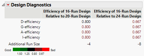

Figure 17.29 Design Diagnostics for Three Designs
Figure 17.29 shows the Design Diagnostics report for the three designs constructed in Example Using Designs of Different Run Sizes, with only main effects in the Model section.
The values in the Design Diagnostics table are colored according to a color gradient shown under the table. You can control the color legend using the options in the Design Diagnostics red triangle menu. See Color Dashboard.
