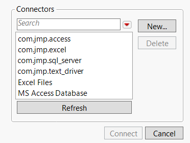

1. Select File > Database > Data Connectors. The Connector box lists data sources that you have established a connection to.
2. Click New Connection.
The Select Data Connector window displays the New Connection dialog.
Figure 3.51 The New Connection Dialog
3. Select a data connector here from the registry of built-in connectors, add-in connectors supplied by your organization, and user-created connectors. Built-in connectors are prefixed with com.jmp, add-in connectors are prefixed with an add-in ID, and user-created connectors have no prefix. New connectors will need to be configured using the configuration options listed in Configure a Data Connector.
4. With a configured data connector selected, click Connect.
The New Connection dialog closes, returning you to the Select Data Connector window.

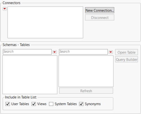

The Select Data Connector window appears (Figure 3.52).
2. If you are already connected to the database, select it in the Connections box.
The Connectors box lists data sources to which JMP is connected. The Schemas - Tables box lists schemas for those databases that support them.
Figure 3.52 Select Data Connector Window Before Establishing Any Connections
3. If the desired data source is not listed in the Connectors box, click New Connection to choose a data connector. Follow the steps in Configure a Data Connector.
4. Select the desired data source in the Connectors box. The tables list in the Tables box updates accordingly. The update might take several seconds, depending on the number of tables and the speed of the connection to the database. If your database supports schemas, tables are loaded for the first schema in the list, and on other schemas as you click them.
5. Control which tables are listed by choosing the options in the Include in Table List group of check boxes.
Note: Different drivers interpret these labels differently.
User Tables When clicked, displays all available user tables in the Tables list. User tables are specific to which user is logged on to the computer.
Views When clicked, displays “views” in the Tables list along with all other file types that can be opened. “Views” are virtual tables that are query result sets updated each time you open them. They are used to extract and combine information from one or more tables.
System Tables When clicked, displays all available system tables in the Tables list. System tables are tables that can be used by all users or by a system-wide service.
Synonyms When clicked, displays all available ORACLE synonyms in the Tables list.
6. Select the desired table from the Tables list.
7. Click Open Table to import all the data in the selected table, or click Query Builder to specify a subset of the table to be imported. See Build SQL Queries in Query Builder.
You might see a short delay when opening large tables. To see the status of all active ODBC queries, select View > Running Queries.

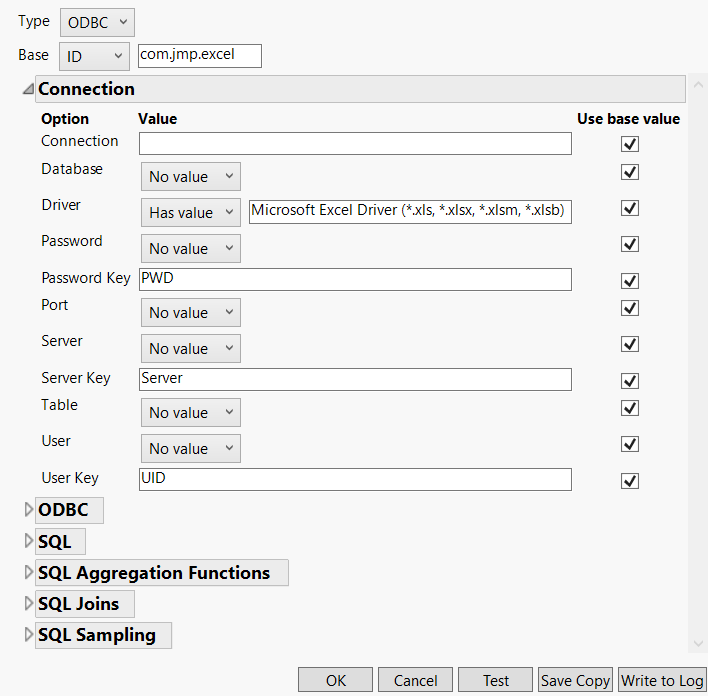

The Data Connector Editor window appears after selecting New in the Select Data Connector window. Configure options for connecting to a database in this window, such as login credentials and SQL formatting.
For the fields in the Connection group corresponding to ODBC connection string keys, setting them to No value corresponds to not specifying them in the connection string. Options that accept a Boolean accept the values ON and OFF.
Figure 3.53 The Data Connector Editor Window

Supports Row Sampling
(Boolean) Specifies whether sampling can (or can only) be done by rows.
Supports Sampling First N Rows
(Boolean) Specifies whether getting the first N rows of the result is supported for a user-given N, as with LIMIT 1000 in PostgreSQL.
Supports Sampling N Rows
(Boolean) Specifies whether getting N random rows from the result is supported for a user-given N, as with TABLESAMPLE (1000 ROWS) in SQL Server.
Supports Sampling N Rows and Order By
(Boolean) Specifies whether getting a number of random rows and ordering the output (with ORDER BY) can be used at the same time. This is "OFF" for databases like PostgreSQL, where getting a number of random rows is implemented with an operation like ORDER BY RANDOM() LIMIT 1000, which makes the ORDER BY clause unavailable for its usual purpose.
Supports Sampling Percent
(Boolean) Specifies whether getting the sampling percent of the result is supported for a user-given N, as with TABLESAMPLE (10 PERCENT) in SQL Server.
Test
Attempts to connect using the given values and displays a message box confirming if the test was successful.
Save Copy
After providing an ID, saves the current state of the editor and registers it in the list of available connectors in the Select Data Connector window with said ID. See Establish a Connection.
Write to Log
Writes the current state of the editor to the log. The text written to the log can be used to create a configuration file.
