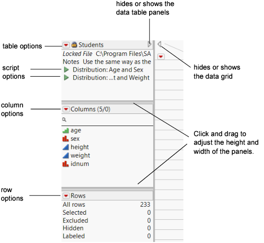

In JMP data tables, the Table, Columns, and Rows panels contain information about the data table and its contents.These interactive panels are located on the left of the data grid.
Figure 2.4 Interacting with the Data Table Panels
Table Panel in Data Tables
The Table panel contains the following elements:
• Name of the data table
• Icons indicating the table state
• Red triangle menus containing table options
• (Optional) Table variables
• (Optional) Green triangles for table scripts
Figure 2.5 Example of a Table Panel

In the Table panel, you can also perform the following tasks:
• Double-click a table variable or script name to edit the name and content.
• Drag a table variable or script to rearrange it.

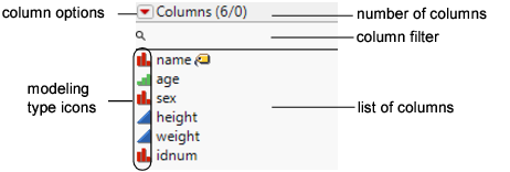

Columns Panel in Data Tables
The Columns panel provides a way to view and move columns. The panel contains the following information:
• Column options (contains some of the same options as the Cols menu)
• Total number of columns and number of columns selected in the data table
• A filter box to help you quickly find columns (click the magnifying glass icon to set search filter options and parameters)
• A list of columns found in the data table
• Icons indicating each column’s modeling type (see “About Modeling Types”)
• Icons representing characteristics and properties assigned to the columns (not shown, see Figure 2.7)
Figure 2.6 Example of a Columns Panel

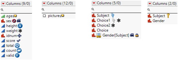

Icons Representing Column Characteristics and Properties
Icons to the right of each column name indicate characteristics and properties the columns contain.
Figure 2.7 Icons Indicating Column Characteristics and Properties
Note: Italics indicate that the column is locked into place. When you scroll horizontally, the column remains visible.
Here are the icons that can appear in the Columns panel:
Image shown here Indicates that points on plots corresponding to the column are labeled by the value instead of the row number. See “Label Rows and Columns”.
Image shown here Indicates that the column is excluded from the calculations. See “Exclude Rows in Data Tables”.
Image shown here Indicates that the column is not included in graphs. See “Hide Rows in Data Tables”.
Image shown here Can be X or Y. Indicates that the column has been assigned the preselected role of x or y. See “Assign a Preselected Analysis Role to a Column”.
Image shown here Indicates that the column has been assigned the preselected role of validation. See “Assign a Preselected Analysis Role to a Column”.
Image shown here Indicates that the column contains one or more properties. Click to reveal a list of properties the column contains.
Image shown here Indicates that the values in the column result from a formula. When formula evaluation is suppressed, the icon appears gray. Double-click to view and edit the formula. See “JMP Formula Editor Options”.
Image shown here Indicates that the range check or the list check option is turned on. Click to view and edit the range or list. See “Range Check” and “List Check”.
Image shown here Indicates that the column has been assigned the preselected role of weight. See “Assign a Preselected Analysis Role to a Column”.
Image shown here Indicates that the column has been assigned the preselected role of frequency. See “Assign a Preselected Analysis Role to a Column”.
Image shown here Indicates that the column values cannot be edited. See “About the Column Info Window”.
Image shown here Indicates that the expression column contains images that can be used as markers. See “Use Images as Markers”.

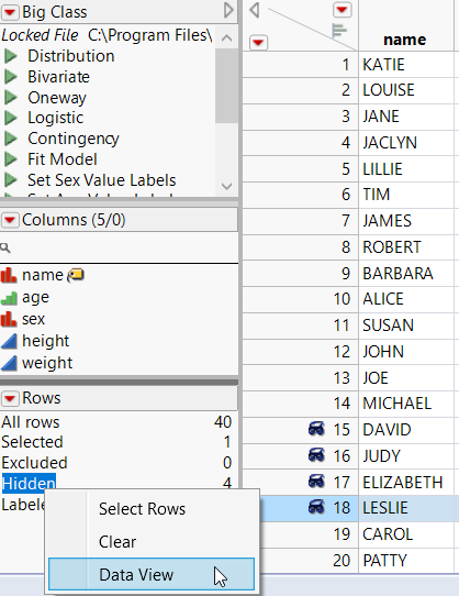

Right-click the categories in the Rows panel to select rows, clear the selection, or to create a data view.
A data view creates a linked subset of the main data table. For example, if several rows are marked hidden, you might want to open a window that shows you only the hidden rows. Right-click Hidden in the Rows panel and select Data View.
Figure 2.9 Creating a Data View from the Rows Panel
When using a data view, continue to do most of your editing in the main data table. When you make changes in either the main data table or in the data view, the changes are reflected in both. You can make minor changes (such as changing some data or adding a column) in the data view. However, if you want to make major changes (like adding a formula) you must make those changes in the main data table.
