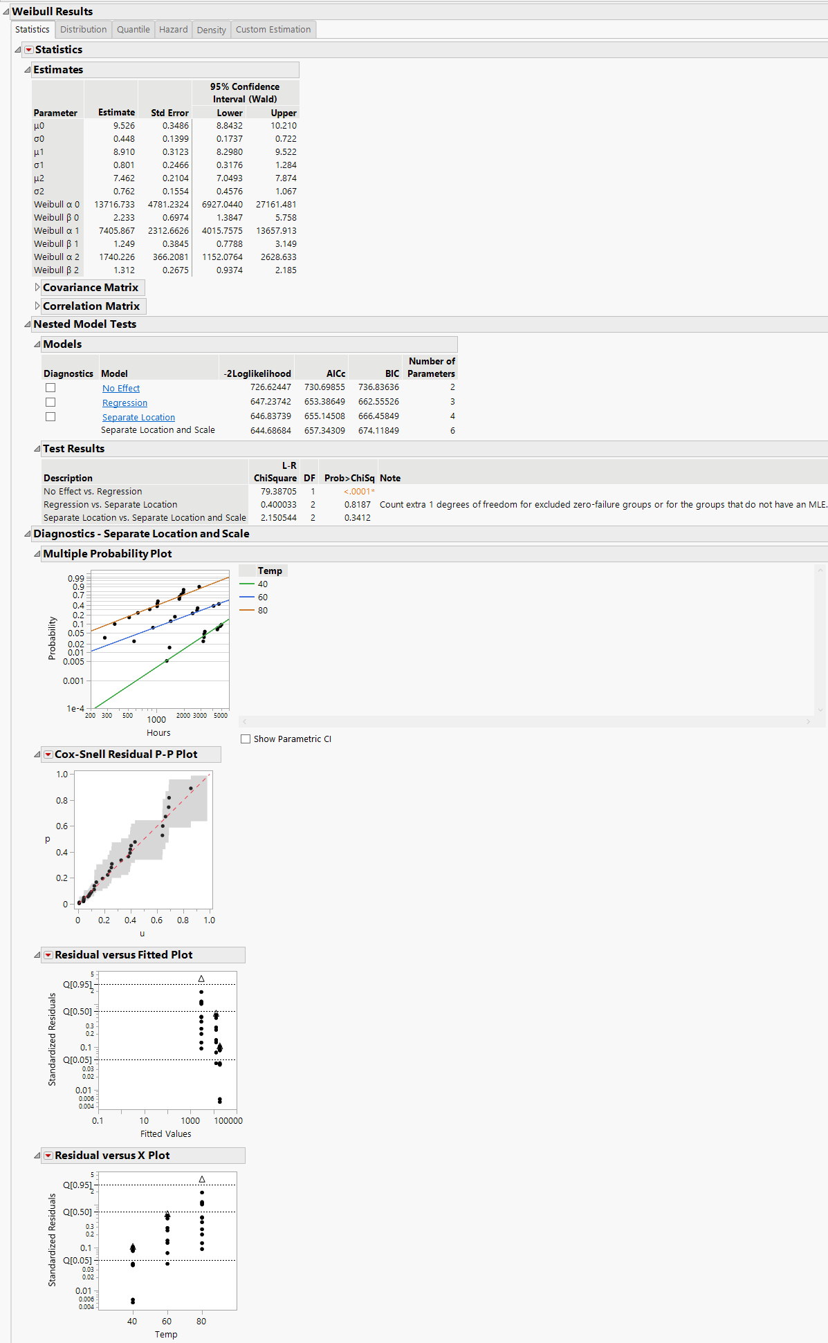

Figure 4.12 Weibull Distribution Nested Model Tests

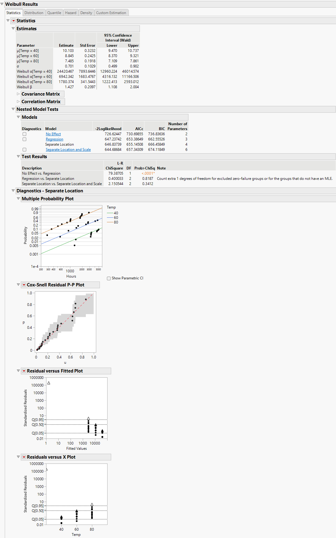

Separate Location and Scale
Assumes that the location and scale parameters are different for all levels of the explanatory variable. This option is equivalent to fitting the distribution by the levels of the explanatory variable. The Separate Location and Scale model has multiple location parameters and multiple scale parameters (Figure 4.13).

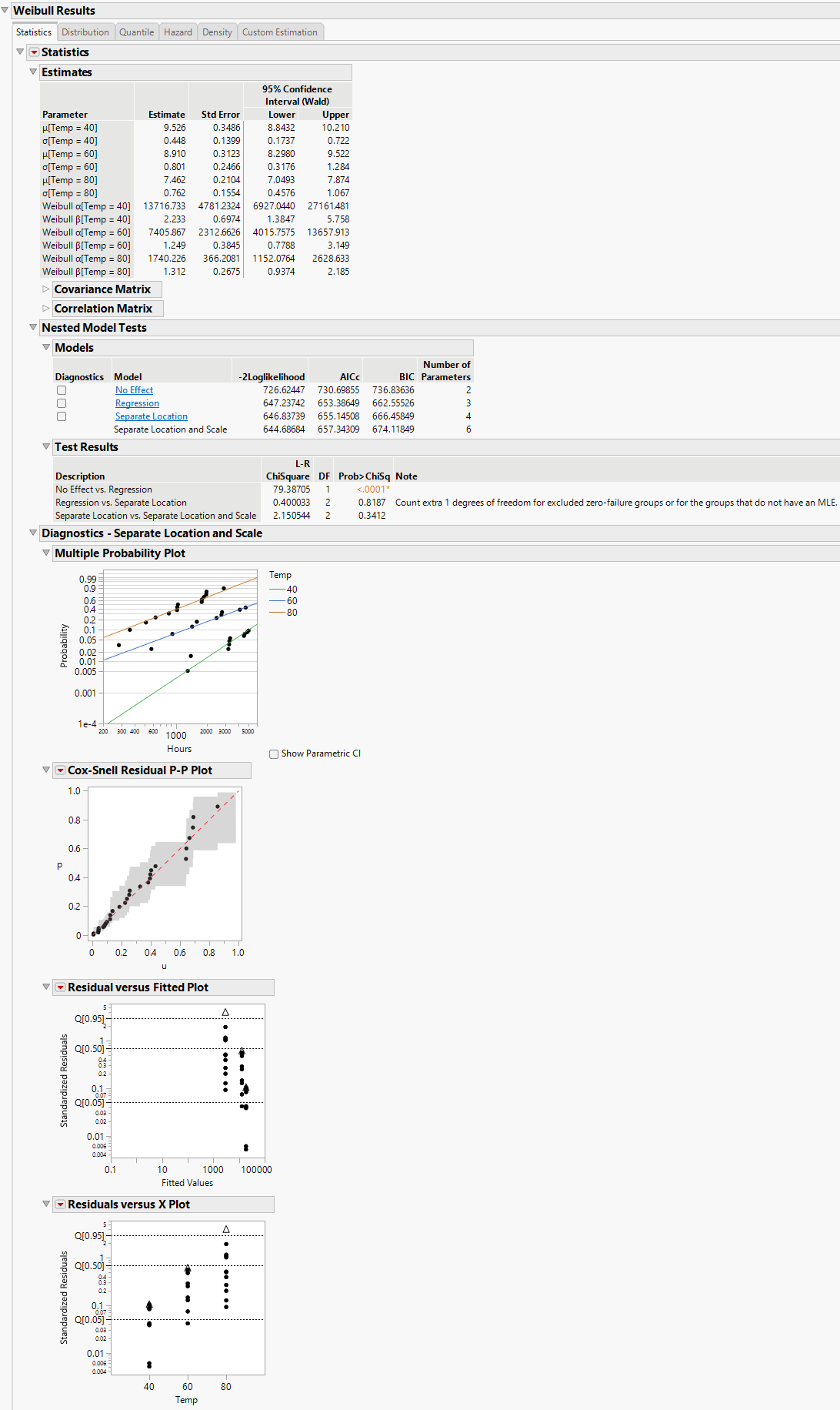

Separate Location
Assumes that the location parameters are different, but the scale parameters are the same for all levels of the explanatory variable. The Separate Location model has multiple location parameters and only one scale parameter (Figure 4.14).

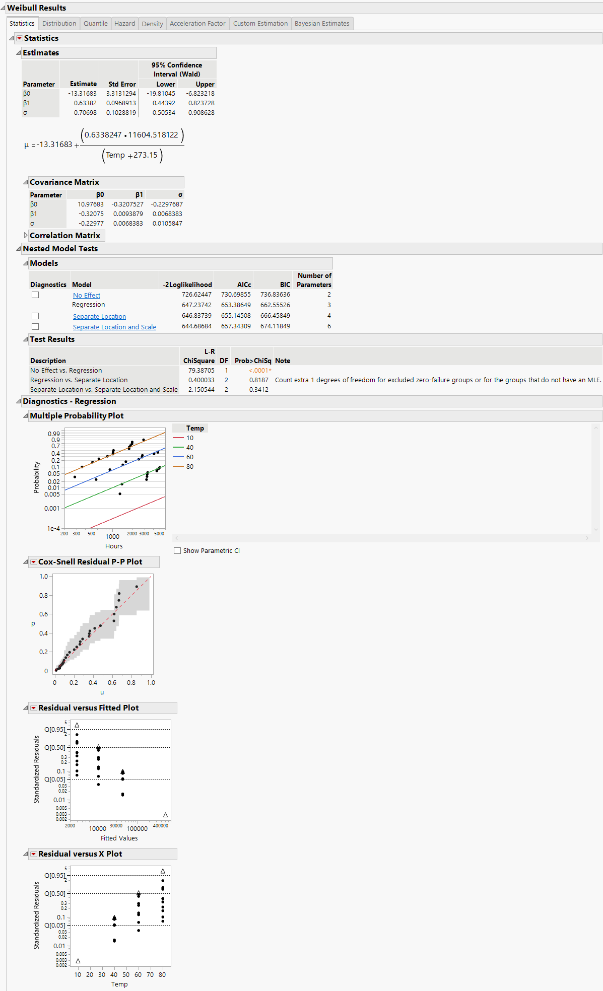

Regression
The default model shown in the initial Fit Life by X report window (Figure 4.15).

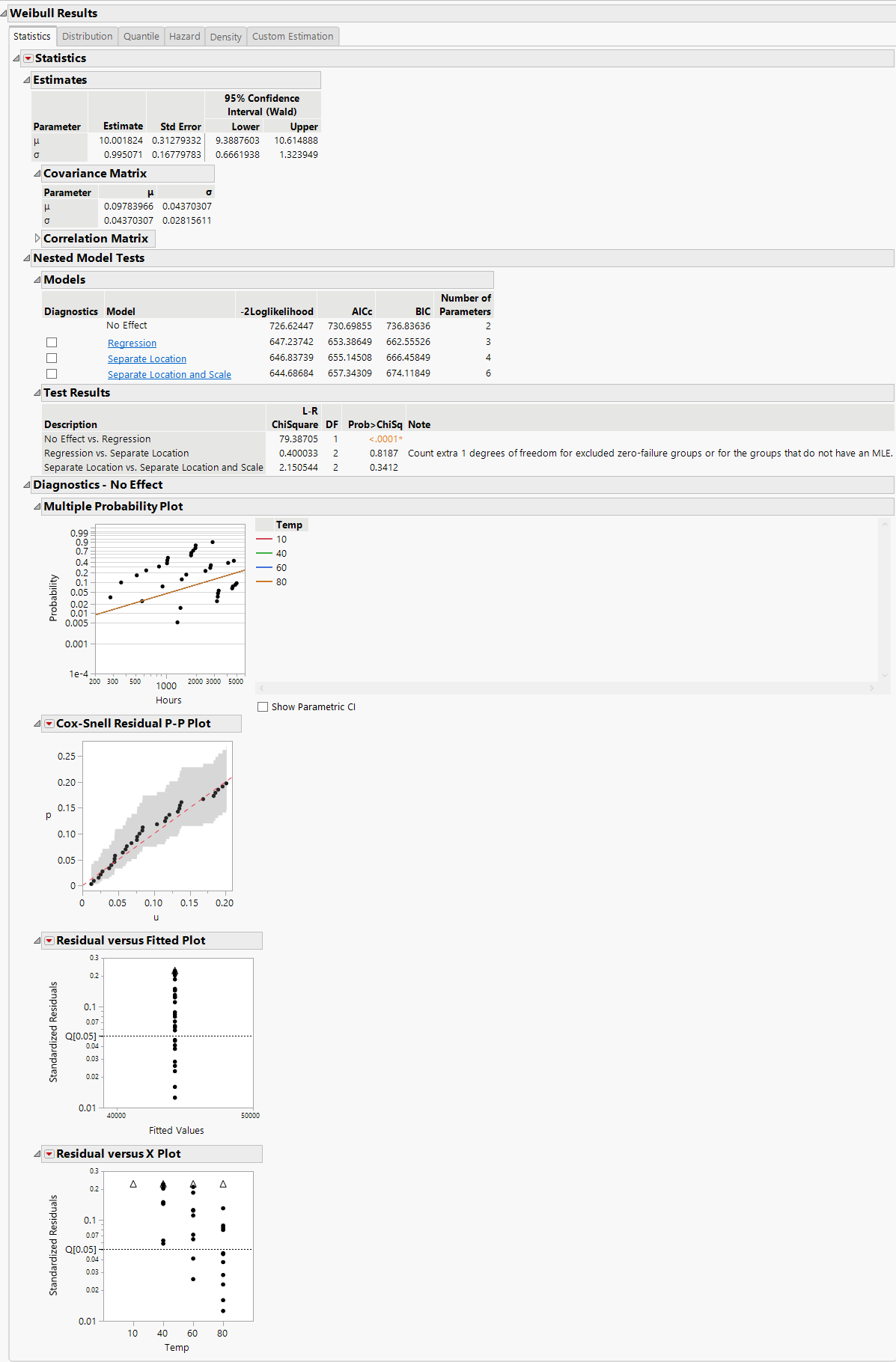

No Effect
Assumes that the explanatory variable does not affect the response. This option is equivalent to fitting all of the data values to the selected distribution. The No Effect Model has one location parameter and one scale parameter (Figure 4.16).

Note: When Separate Location and Scale or Separate Location models are fit for the Weibull distribution, both parameterizations of the Weibull distribution are shown in the Estimates table, as is the case in Figure 4.13 and Figure 4.14. For more information about the Weibull parameterizations, see “Weibull”.

The Multiple Probability Plots shown in Figure 4.12 are used to validate the distributional assumption for the different levels of the accelerating variable. If the line for each level does not run through the data points for that level, the distributional assumption might not hold. Side-by-side comparisons of the diagnostic plots provide a visual comparison for the validity of the different models. See Meeker and Escobar (1998, sec. 19.2.2) for a discussion of multiple probability plots. Each multiple probability plot has an option below the legend that enables you to show or hide shaded parametric confidence intervals for each line in the plot.
The Cox-Snell Residual P-P Plots are used to validate the distributional assumption for the data. If the data points deviate far from the diagonal, then the distributional assumption might be violated. The Cox-Snell Residual P-P Plot red triangle menu has an option called Save Residuals that enables you to save the residual data to the data table. See Meeker and Escobar (1998, sec. 17.6.1) for a discussion of Cox-Snell residuals.
The Residuals versus Fitted Plots and Residuals versus X Plots are used to validate the distributional assumption for the different levels of the accelerating variable. The plots show standardized residuals on the vertical axis and either the fitted values or the values of the X variable on the horizontal axis. The Residuals versus Fitted and Residuals versus X red triangle menu have an option called Save Residuals that enables you to save the standardized residual data to the data table.
Figure 4.13 Separate Location and Scale Model with the Weibull Distribution
Figure 4.14 Separate Location Model with the Weibull Distribution
Figure 4.15 Regression Model with the Weibull Distribution
Figure 4.16 No Effect Model with the Weibull Distribution

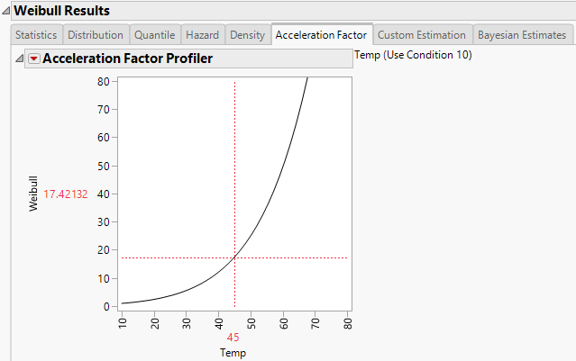

The report window also includes a tab labeled Acceleration Factor. Select the Acceleration Factor tab to show the Acceleration Factor Profiler. This profiler is an enlargement of the Weibull plot shown under the Acceleration Factor tab in the Comparisons section of the report window. Figure 4.17 shows the Acceleration Factor Profiler for a Weibull distribution fit. The use condition level for the explanatory variable can be modified by selecting the Set Time Acceleration Use Condition option in the Fit Life by X red triangle menu.
Figure 4.17 Weibull Acceleration Factor Profiler
