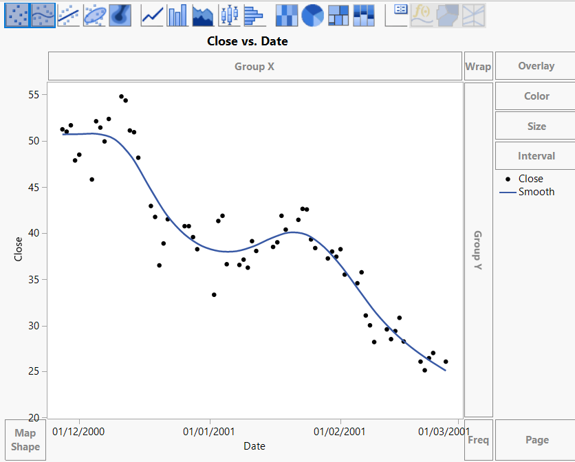

Figure 4.32 Overlay Plot with Smoother
5. Click the Smoother icon Image shown here above the graph to remove the smoother line.

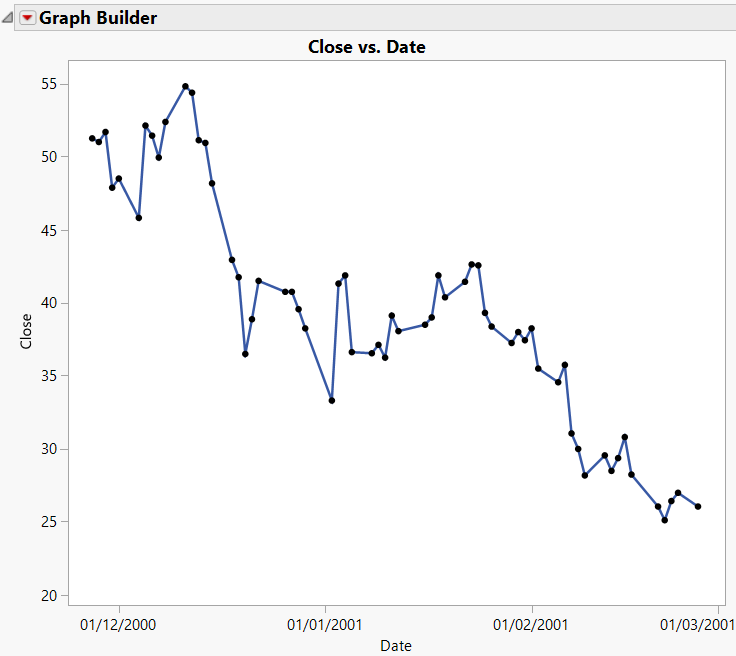

Figure 4.33 Overlay Plot of the Closing Price over Time
Interpret and Interact with the Overlay Plot
The overlay plot shows that the closing stock price has been decreasing over the last several months. To see the trend more clearly, connect the points.
1. Press Shift and click the Line icon Image shown here above the graph. Pressing Shift applies additional types without deselecting other types.
Figure 4.34 Connected Points
Connected Points
The potential investor can see that although the stock price has gone up and down over the past three months, the overall trend has been downward.
