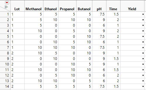

Figure 8.13 Definitive Screening Design with Block for Extraction Process
Notice that run 1 is a center point run in Lot 1 and run 14 is a center point run in Lot 2.

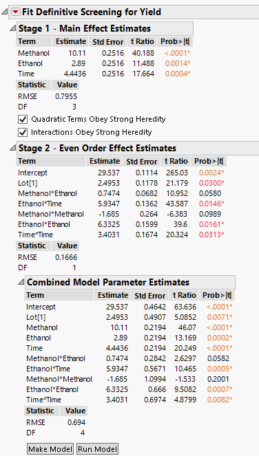

Figure 8.14 Fit Definitive Screening Report
The effects identified by Fit Definitive Screening as potentially active are listed in the Combined Model Parameter Estimates report.
3. Click the Run Model button at the bottom of the Combined Model Parameter Estimates report.
This fits a standard least squares model to the effects identified as potentially active.

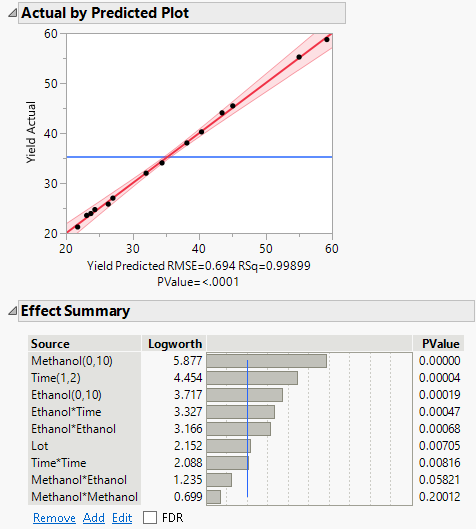

Figure 8.15 Standard Least Squares Report
The Actual by Predicted Plot shows no evidence of lack of fit. The Effect Summary report shows that Methanol*Ethonal and Methanol*Methanol are not significant. You decide to remove these effects from the model.
4. Select Methanol*Ethonal and Methanol*Methanol in the Effect Summary report and click Remove.

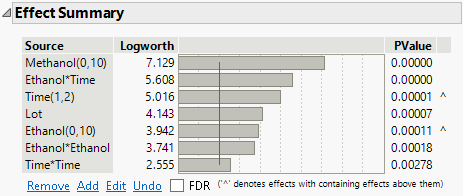

Figure 8.16 Final Set of Active Effects
The remaining effects are all significant. You conclude that these are the active effects.
