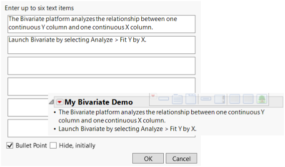

4. To add bullet points into the outline, click the red triangle in the My Bivariate Demo title bar and select Add Text Item.
5. Enter the text shown in Figure 11.33.
Figure 11.33 Add Text Item
Add Text Item
6. Select the Bullet Point check box and click OK.

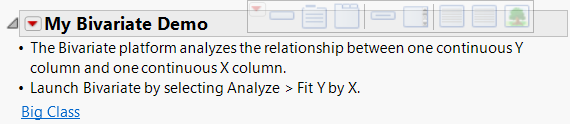

Now add a window reference as a link. These links lets you open a file with one click during the presentation.
7. Select Help > Sample Data Folder and open Big Class.jmp.
8. Click the red triangle in the My Bivariate Demo title bar and select Add Window Reference.
9. Select Big Class and click OK.
Figure 11.34 Add a Window Reference
10. Click the window reference to verify the link.

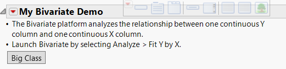

11. Display the window reference as a button by right-clicking the link and selecting Style > Normal.
Figure 11.35 Change the Link to a Button

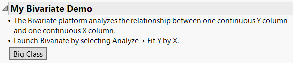

12. Select Edit > Lock Journal to see the final journal.
When you lock the journal, the journal toolbar and insertion cursor no longer appear. And when you select Save Script > To Journal from a platform, the journal is not appended to the open locked journal.
Figure 11.36 Final Journal
Final Journal
