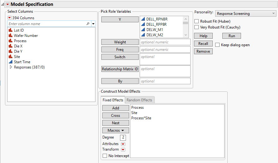

Launch Fit Response Screening by selecting Analyze > Fit Model and selecting Response Screening from the Personality list. You can specify models with fixed effects, random effects, or a combination of both using the tabs in the Construct Model Effects section.
Figure 24.6 Response Screening from the Fit Model Window in JMP Pro

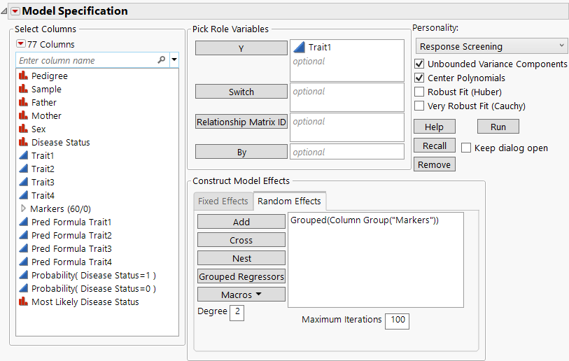

Specify traditional variance component models and models with grouped regressors using the Random Effects tab. For a traditional variance component model, specify terms such as random blocks, whole plot error terms, and subplot error terms using the Add, Cross, or Nest options. For more information about these options, see Model Specification in Fitting Linear Models.
Figure 24.7 Response Screening with Random Effects in JMP Pro
Use the Grouped Regressors button in the Random Effects tab to add a set of random continuous columns as a group effect that is associated with a single variance component. This approach is often used in genetics applications when there are a large number of genetic SNP or expression columns. The easiest way to add a grouped regressor is to first use Group Columns to group the columns of interested in the data table.
Note: If there are non-continuous factors in a group of regressors, the entire group is not included in the analysis.
When fitting models with random effects using the Response Screening personality, variance components are allowed to have negative estimates. The Unbounded Variance Components option specifies that variance components that have negative estimates are not reported as zero. This option is selected by default. It should remain selected if you are interested in fixed effects, because bounding the variance estimates at zero leads to bias in the tests for fixed effects. See “Negative Variances” in Fitting Linear Models for more information about the Unbounded Variance Components option.
