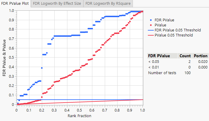

Figure 24.1 Example of a Response Screening PlotĀ
