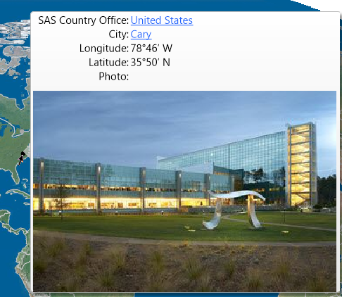

7. Hover over a data point or a histogram bar.
The image appears on the label. To see an example, run the Graph Builder script in the SAS Offices.jmp sample data table.
Figure 9.86 Image on Hover Label
