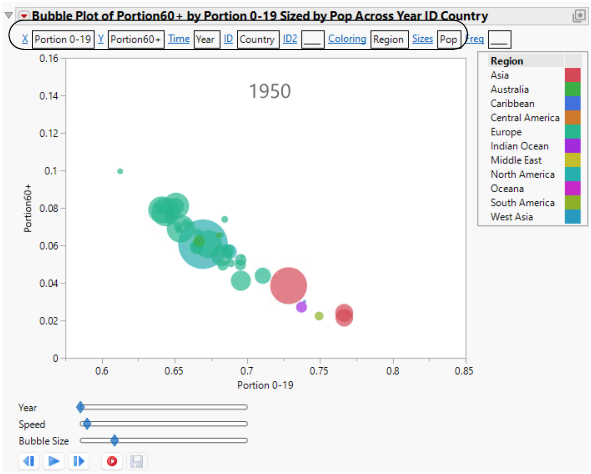

In the Bubble Plot red triangle, use the Show Roles option to change existing variables without having to relaunch the platform and restart your analysis.
Follow the instructions in Example of a Dynamic Bubble Plot to produce the report window shown in Figure 5.6. (The colors are the JMP default colors.)
Figure 5.6 Example of Bubble Plot with Show Roles Selected

To change the variable that is assigned to a role, click a blue underlined role name. For example, perform these steps to change the Coloring variable in Figure 5.6:
1. Click the Bubble Plot red triangle and select Show Roles.
2. Click the Coloring link.
The Select column for Coloring window appears.
3. Click Country.
4. Click OK.
Country now replaces Region as the Coloring variable in the bubble plot.
