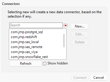

3. Select a data connector from the registry of built-in connectors, add-in connectors supplied by your organization, and user-created connectors.
Built-in connectors are prefixed with com.jmp, add-in connectors are prefixed with an add-in ID, and user-created connectors have no prefix. New connectors must be configured by using the configuration options listed in Configure a Data Connector.
4. With a configured data connector selected, click Connect.
The New Connection window closes, returning you to the Select Data Connector window.

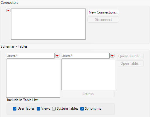

1. Select File > Connect To > Data Connectors.
The Select Data Connector window appears (Figure 3.52).
2. If you are already connected to the database, select it in the Connections box.
The Connectors box lists data sources to which JMP is connected. The Schemas - Tables box lists schemas for the databases that support them.
Figure 3.52 Select Data Connector Window Before Establishing Any Connections
3. If the wanted data source is not listed in the Connectors box, click New Connection to choose a data connector.
Follow the steps in Configure a Data Connector.
4. Select the wanted data source in the Connectors box.
The tables list in the Tables box updates accordingly. The update might take several seconds, depending on the number of tables and the speed of the connection to the database. If your database supports schemas, tables are loaded for the first schema in the list. Tables for other schemas are loaded as you click them.
5. Control which tables are listed by choosing the options in the Include in Table List group of check boxes.
Note: Different drivers interpret these labels differently.
User Tables When clicked, displays all available user tables in the Tables list. User tables are specific to which user is logged on to the computer.
Views When clicked, displays views in the Tables list along with all other file types that can be opened. Views are virtual tables that are query result sets that are updated each time you open them. They are used to extract and combine information from one or more tables.
System Tables When clicked, displays all available system tables in the Tables list. System tables are tables that can be used by all users or by a system-wide service.
Synonyms When clicked, displays all available ORACLE synonyms in the Tables list.
6. Select the wanted table from the Tables list.
7. Click Open Table to import all the data in the selected table, or click Query Builder to specify a subset of the table to be imported.
See Build SQL Queries in Query Builder.
You might see a short delay when opening large tables. To see the status of all active ODBC queries, select View > Running Queries.
Note: If the data were previously exported to a database in JMP and contained an Expression column, the column is imported as a Character column. Select Cols > Column Info and change the Data Type to Expression.

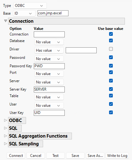

The Data Connector Editor window appears after selecting New in the Select Data Connector window. Configure options for connecting to a database in this window, such as login credentials and SQL formatting.
For the fields in the Connection group that correspond to ODBC connection string keys, setting them to No value corresponds to not specifying them in the connection string. Options that accept a Boolean accept the values ON and OFF.
Figure 3.53 The Data Connector Editor Window
Data Connector Editor Window Options
Base
Specifies the type of key to use to load a base configuration.
None
Provides a blank configuration with all fields at their default values.
ID
Provides a configuration that is associated with the provided ID.
File
Provides a configuration that is associated with the provided file path.
Spec
Provides a configuration that is associated with the provided specification. Specifications use a restricted form of JSL with the syntax KEY1 = VALUE1; KEY2 = VALUE2; where KEY refers to a keyword like ID or Server, and VALUE refers to the ID or Server value of a data connection. Spec can be useful for testing configurations by accessing specific data sources through a named data connector configuration ID.
Connection
Provides options for connecting to a database.
Connection
Specifies an ODBC connection string.
Database
Specifies the name of the database for the connection.
Driver
Specifies the name of the driver.
Password
Specifies the password for access to the database.
Password Key
Specifies the connection string key to map to the value of the Password field.
Port
Specifies the port value.
Server
Specifies the name of the server instance.
Server Key
Specifies the connection string key to map to the value of the Server field.
Table
Specifies the name of the table to open.
User
Specifies the server login name.
User Key
Specifies the connection string key to map to the value of the Username field.

Existing data connectors can be edited from the Select Data Connector Window. In order to appear in the Select Data Connector window, a data connector must have an established connection.
2. Select New Connection.
3. Select a previously configured and connected data connector, then select Edit.
The Select Data Connector window appears.
2. Select New Connection to choose a data connector.
3. In the dialog that appears, select com.jmp.excel from the list of available data connectors.
4. Select New.
The Data Connector Editor window appears.
5. In the Connection field, provide the path to the file you want to connect to in the following format:
DBQ={C:\Users\YourName\Documents\data.xslx};
6. Select Connect to connect to the provided XSLX file.
