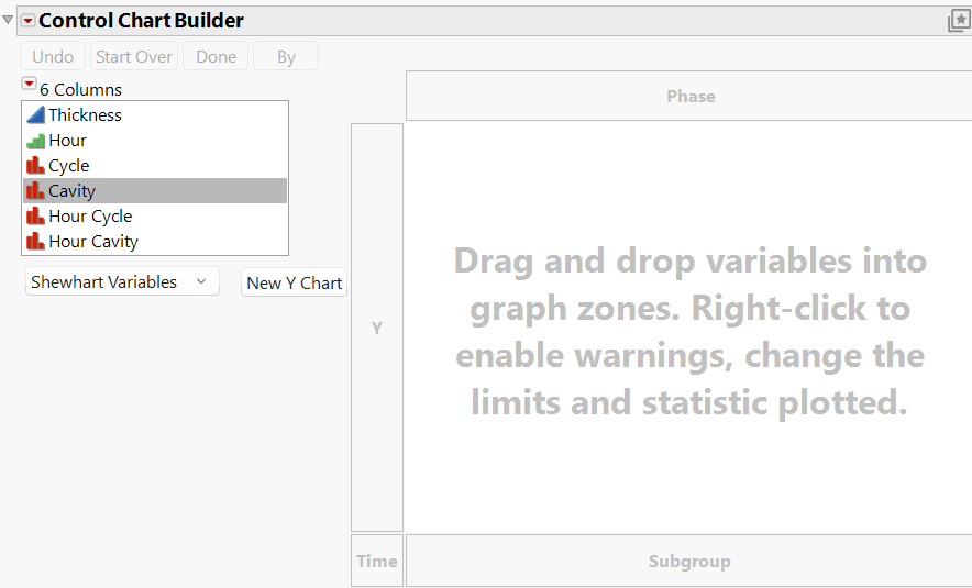

To begin creating a control chart interactively, drag variables from the Select Columns box into the zones. If you drop variables in the center, Control Chart Builder guesses where to put them based on whether the variables are continuous or categorical.
Figure 3.4 Interactive Control Chart Builder Window
The Control Chart Builder workspace contains the following zones:
Y
Assigns the process variable.
Time
Assigns a sample label variable to uniquely label individual measurements. The labels are not aggregated or sorted and appear on the horizontal axis in the same order they appear in the data table.
Subgroup
Assigns subgroup variables. To define subgroup levels as a combination of multiple columns, add multiple variables to the Subgroup zone. When a subgroup variable is assigned, each point on the control chart corresponds to a summary statistic for all of the points in the subgroup.
Phase
(Not available for Rare Event control charts.) Assigns a phase variable. When a Phase variable is assigned, separate control limits are computed for each phase. See also Example of an XBar and R Chart.
Part
(Available only for Short Run control charts.) Assigns the Part variable. When a Part variable is assigned, statistics are calculated for each product, or level of the Part variable. These statistics are used to calculate the control limits.
n Trials
(Available for Attribute charts.) Assigns a lot size for an attribute control chart.
