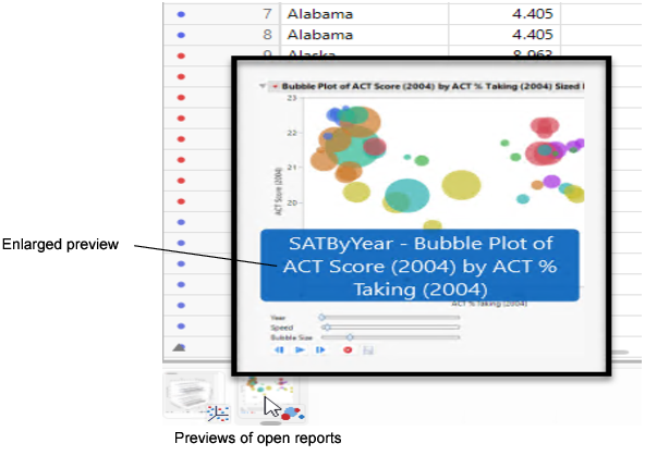

• To open an associated report when you are viewing a data table, double-click the thumbnail preview of the report in the bottom pane. To enlarge the preview, hover over the thumbnail (Figure 2.16).
• Middle-click the thumbnail preview to close the associated report. You can also right-click and select Close.
Figure 2.16 Thumbnail Previews of Open Reports
