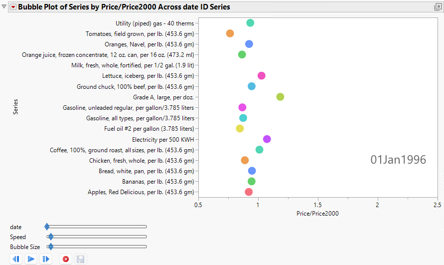

The report window appears. (Figure 5.15 uses the JMP default colors.)
These steps produce a bubble plot that, when animated by clicking the play button, shows the price bubbles moving side to side according to their price ratio.
Figure 5.15 Static Example of Animated Bubbles

To animate the bubble plot, click the play button. The price bubbles move side to side according to their price ratio.
