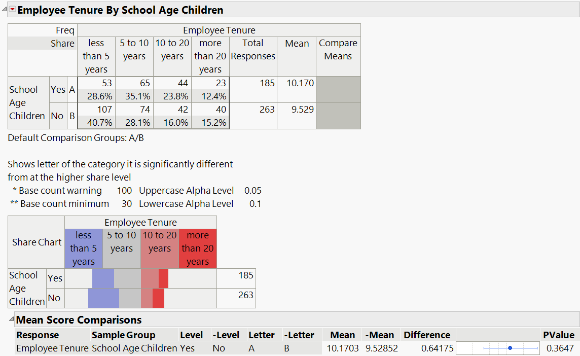

Figure 3.42 Categorical Report with Mean Score Comparisons
The mean employee tenure for those with school age children is 10.17 and 9.53 for those without school age children. Because the means are not statistically different, the Compare Means column in the crosstab table is empty. If there were a difference, a letter would indicate the difference. The Mean Score Comparisons table provides the group means, their difference, a forest plot, and the p-value for the test of group differences. If you had not used value scores, then the mean for those with school age children would be 2.20 and 2.057 for those without school age children.
