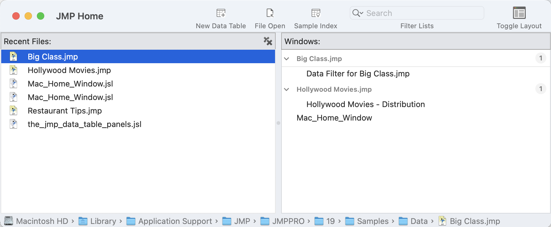

Open the JMP Home window on Apple macOS by selecting Window > JMP Home (Figure 2.15). To view the window each time you open JMP, select JMP > Preferences > General > Home Window.
Figure 2.15 Example of the JMP Home Window (Apple macOS)
Tips:
• The Status bar area shows the path for the currently selected file. You can click a folder to open the folder to view its contents.
• To be able to quickly view the JMP Home window from any JMP window, press Ctrl and click the window, select Customize Toolbar, and drag the JMP Home icon to the toolbar.
• To copy a file from Recent Files to another document or into the Finder, select the file and then select Edit > Copy.
