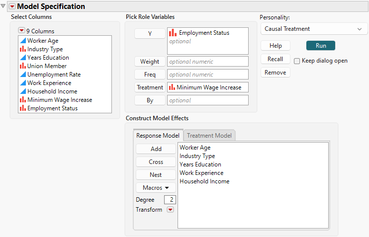

Image shown hereResponse Model Tab
Add variables to model the outcome on the Response Model tab. Use the Add, Cross, Nest, and Macros options as needed. The Transform options enable you to apply functions to the chosen variables. For more information about these options, see “Construct Model Effects Tabs”.
Binary Treatment
When the treatment is binary, two response models are fit using generalized linear mixed modeling (GLMM): one model for each level of the treatment, with the chosen variables as fixed effects. See “Generalized Linear Mixed Models” for more information about this method.
Figure 14.6 Fit Model Launch Window Showing Response Model Tab
The response is modeled using logistic regression with a logit link when the outcome (Y) is binary and using linear regression when the outcome is continuous. If no variables are specified for the response model, only the treatment model is used to estimate causal effects.
Continuous Treatment
When the treatment is continuous, any variables that are selected for the response model are ignored. See Statistical Details for Continuous Treatment Methods for information about how the response models are automatically fit.

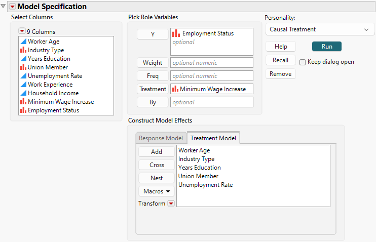

Image shown hereTreatment Model Tab
Add variables to model the treatment on the Treatment Model tab. Use the Add, Cross, Nest, and Macros options as needed. The Transform options enable you to apply functions to the chosen variables. For more information about these options, see “Construct Model Effects Tabs”.
Binary Treatment
When the treatment is binary, the treatment model is fit using GLMM with the chosen variables as fixed effects. Specifically, the treatment variable is modeled using logistic regression with a logit link. If no variables are specified for the treatment model, only the response model is used to estimate causal effects.
Figure 14.7 Fit Model Launch Window Showing Treatment Model Tab
When the treatment is continuous, it is necessary to specify the treatment model. The treatment model is fit using GLMM with the chosen variables as fixed effects. Specifically, the treatment variable is modeled using linear regression.
