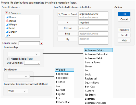

Launch the Fit Life by X platform by selecting Analyze > Reliability and Survival > Fit Life by X.
Figure 5.4 The Fit Life by X Launch Window
The Fit Life by X launch window contains the following options:
Y, Time to Event
Identifies the time to event (such as the time to failure) or time to censoring. With interval censoring, specify two Y variables, where one Y variable gives the lower limit and the other Y variable gives the upper limit for each unit. For more information about censoring, see “Event Plot”.
X
Identifies the accelerating factor.
Censor
Identifies censored observations. Select the value that identifies right-censored observations from the Censor Code menu beneath the Select Columns list. The Censor column is used only when one Y is entered.
Freq
Identifies frequencies or observation counts when there are multiple units. If the value is 0 or a positive integer, then the value represents the frequencies or counts of observations for each row when there are multiple units recorded.
By
Identifies a column that creates a report consisting of separate analyses for each level of the variable.
Censor Code
Identifies the value in the Censor column that designates right-censored observations. After a Censor column is selected, JMP attempts to automatically detect the censor code and display it in the box. To change this, click the red triangle and select from a list of values. You can also enter a different value in the box. If the Censor column contains a Value Labels column property, the value labels appear in the list of values. Missing values are excluded from the analysis.
Relationship
Identifies the relationship between the time to event variable and the accelerating factor. Table 5.1 defines the model for each relationship.
Table 5.1 Models for Relationship Options
Relationship
Model
Arrhenius Celsius
μ = b0 + b1 * 11604.5181215503 / ( X + 273.15 )
Arrhenius Fahrenheit
μ = b0 + b1 * 11604.5181215503 / ( ( X + 459.67 ) / 1.8 )
Arrhenius Kelvin
μ = b0 + b1 * 11604.5181215503 / X
Inverse Power
μ = b0 + b1 * log( X )
Linear
μ = b0 + b1 * X
Log
Logit
μ = b0 + b1 * log( X / ( 1 - X ) )
Reciprocal
μ = b0 + b1 / X
Square Root
μ = b0 + b1 * sqrt( X )
Box-Cox
μ = b0 + b1 * BoxCox( X )
Custom
user-defined μ and σ
No Effect
specifies that μ has the same value for every level of X
Location
specifies that μ is different for every level of X
Location and Scale
specifies that μ and σ are both different for every level of X (equivalent to a Life Distribution fit with X as a By variable)
If you select Box-Cox, a text edit box appears below the Use Condition option. Use this box to specify a lambda value. The BoxCox( X ) transformation for a specified λ is defined as follows:
Equation shown here
If you want to use a Custom relationship for your model, see Custom Relationship.
Nested Model Tests
Appends a nonparametric overlay plot, nested model tests, and a multiple probability plot to the report window.
Use Condition
Enables you to enter a value for the explanatory variable, X, of the acceleration factor. You can also set the use condition value after launching the platform using the Set Time Acceleration Use Condition option from the Fit Life by X red triangle menu.
Distribution
Specifies the distribution (Weibull, Lognormal, Loglogistic, Fréchet, SEV, Normal, Logistic, LEV, or Exponential distributions) that is used to model the relationship between the X and Y variables.
Parameter Confidence Interval Method
Specifies the method that is used to compute confidence intervals for the parameters. Choose between the Wald or Likelihood methods. The Wald method is an approximation and runs faster. The Likelihood method provides more precise parameters but takes longer to compute. The Wald method is the default setting.
Note: The Confidence Interval Method preference enables you to select the Likelihood method as the default parameter confidence interval method. You can change this preference in Preferences > Platforms > Fit Life by X.
