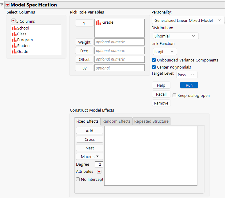

Launch the Generalized Linear Mixed Model personality by selecting Analyze > Fit Model, entering one or more columns for Y, and selecting Generalized Linear Mixed Model from the Personality menu.
Image shown hereFit Model Launch Window
You can specify models with fixed effects, random effects, or a combination of fixed and random effects. You can also specify a distribution for the response variable. The options in the launch window differ based on the nature of the model that you specify. For more information about the options in the Select Columns red triangle menu, see “Column Filter Menu” in Using JMP.
When fitting models using the Generalized Linear Mixed Model personality, you can allow unbounded variance components. This means that variance components that have negative estimates are not reported as zero. This option is selected by default. It should remain selected if you are interested in fixed effects, because bounding the variance estimates at zero leads to bias in the tests for fixed effects. See “Negative Variances” for more information about the Unbounded Variance Components option.
Figure 9.6 Fit Model Launch Window with Generalized Linear Mixed Model Selected
For more information about aspects of the Fit Model window that are common to all personalities, see “Model Specification”. For more information about the options in the Select Columns red triangle menu, see “Column Filter Menu” in Using JMP. Information specific to the Generalized Linear Mixed Model personality is presented here.

Binomial
Specifies that Y has a binomial distribution with parameters p and n. The response, Y, indicates the total number of successes in n independent trials with a fixed probability, p, for all trials. This distribution allows for the use of a sample size column. If no column is listed, it is assumed that the sample size is one. By default, the link function for p is the logit. You can change the link function for p to the probit using the Link Function option in the Fit Model launch window. When you select a binary response variable that has a Nominal modeling type, Binomial is the only available response distribution.
When you select Binomial as the Distribution, the response variable must be specified in one of the following ways.
– Unsummarized: If your data are not summarized as frequencies of events, specify a single binary column as the response. If this column has a modeling type of Nominal, you can designate one of the levels to be the Target Level. The default Target Level value is the higher of the two levels based on the order of the levels.
– Summarized with sample size column entered as second Y: If your data are summarized as frequencies of events (successes) and trials, specify two continuous columns as Y in this order: the count of the number of successes, and the count of the number of trials.

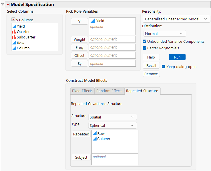

Image shown hereRepeated Structure Tab
Use the Repeated Structure tab to select a covariance structure for repeated effects in the model.
Table 9.3 Completed Fit Model Launch Window Showing Repeated Structure Tab
Image shown here
Structure
The repeated structure is set to None by default. The None structure specifies that there is no covariance between observations, namely, the errors are independent. All other covariance structures model covariance between observations.
Table 9.4 lists the covariance structures that are available, the requirements for using each structure, and the number of covariance parameters for the given structure. The number of observation times is denoted by J.

If you enter a Repeated or Subject column with the None structure, those columns are ignored. This alert appears: “Repeated columns and subject columns are ignored when the Residual covariance structure is selected.”
Type
When you select the Spatial covariance structure, a Type list appears from which you select a type of spatial structure. Four Types are available: Power, Exponential, Gaussian, and Spherical.
Repeated
Enter columns that define the repeated measures structure. The modeling types of Repeated columns depend on the covariance structure. See Table 9.4 for more information about the requirements for each repeated measures covariance structure.
Subject
Enter one or more columns that define the Subject. Subject columns must be categorical.
