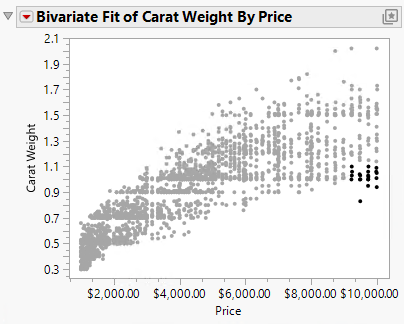

7. Lasso some of the points near the USD 10,000 price at the bottom of the plot (Figure 4.9).
8. In the data table, select Rows > Next Selected (or press F7).
You can easily navigate through the selected rows to see the data for each.
Figure 4.9 Points Selected
Points Selected
