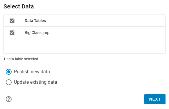

Figure 11.14 Select the Data
Select the Data
Tip: To choose all open data tables, select the Data Tables box.
3. Choose what action you want to take:
– Publish New Data
– Update Existing Data
4. Click Next.

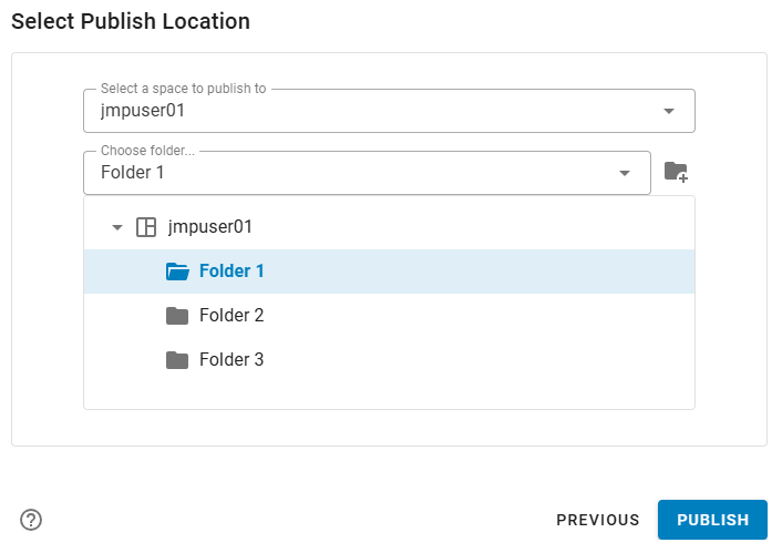

Figure 11.15 Select Where to Publish the Data
1. Select a space from the list or enter text to find a space that you want to publish your data to.
Note: You see only spaces that you have permission to publish to.
2. Select an existing folder from the list or enter text to find the folder where you want to publish your data.
Note: You see only folders that you have permission to view. Folders that you do not have permission to publish to are dimmed with a no publishing icon.
Tip: To create a new folder, click the space or folder where you want to create the folder and click Create folder (Image shown here).
3. Click Publish.

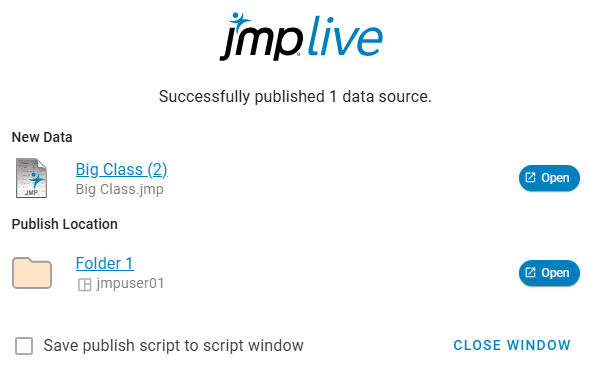

Figure 11.16 Publish Status for a New Data Table
4. (Optional) To save your process as a JSL script, select Save publish script to script window.
5. Click an Open link to launch JMP Live, or click Close Window.

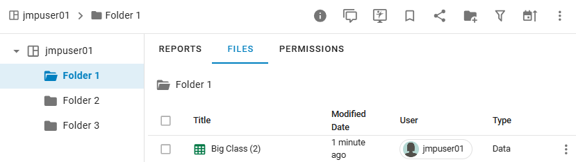

Figure 11.17 Published Data File in JMP Live
Note: Who can see your post depends on space and folder permissions. See the JMP Live Help.

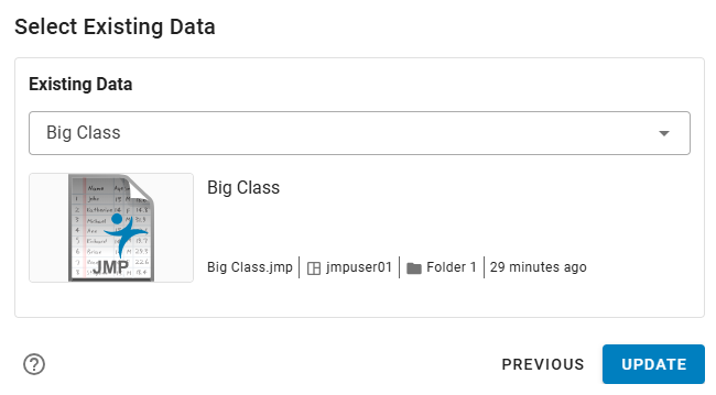

Figure 11.18 Select an Existing Data Table
Note: You see only data tables that you have permission to update.
1. Select a data table from the list or enter text to find a table.
2. Click Update.

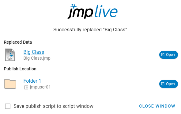

Figure 11.19 Publish Status for Updating a Data Table
3. (Optional, JMP Live only) To save your process as a JSL script, select Save publish script to script window.
4. Click a link to open JMP Live, or click Close Window.
