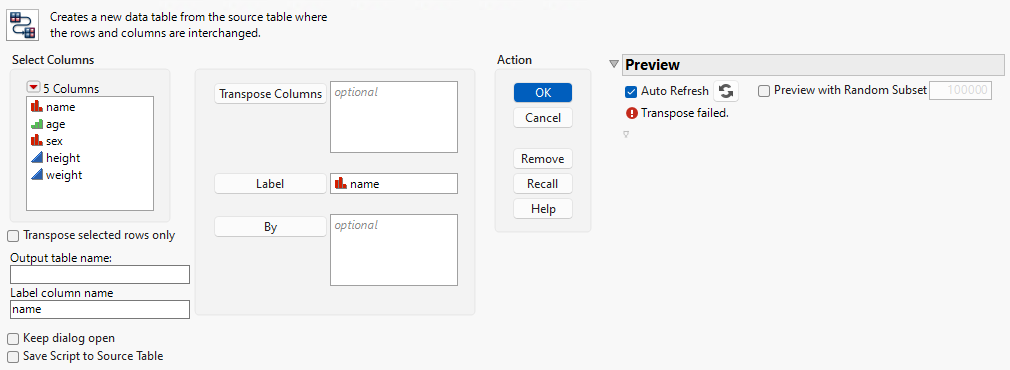

Figure 6.13 Transpose Window
Transpose Window
3. Highlight the column names that you want to transpose in the Select Columns box.
4. Click Transpose Columns.
5. (Optional) Customize your transposed table further by using the additional options.
6. Click OK.
Transpose Options
Select Columns Filter Menu
Contains options to search and filter through columns. See “Column Filter Menu”.
Transpose selected rows only
Transposes only rows that are currently highlighted in the active table.
Output table name
(Optional) Specifies the name of the subset table.
Label column name
(Applicable only if you have specified a Label column) Specifies an alternative name for the Label column. Otherwise, the default column name is Label.
Keep dialog open
Keeps the Transpose window open after you click OK.
Save Script to Source Table
Saves a script to the original data table that enables you to transpose the data again by using the same settings.
