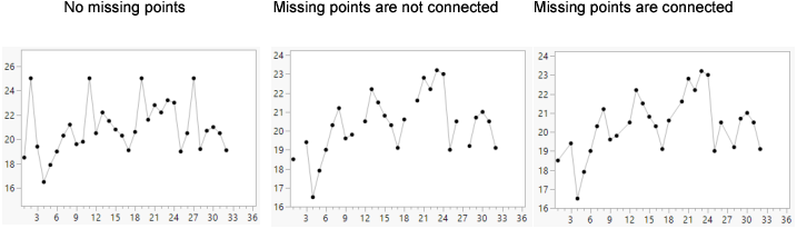

Connects points when some samples have missing values. In Figure 13.10, the left chart has no missing points. The middle chart has samples 2, 11, 19, and 27 missing with the points not connected. The right chart appears if you select the Connect Through Missing option, which is the default.
Figure 13.10 Example of Connected through Missing Option

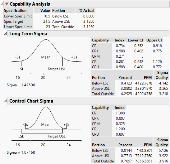

An example of a capability analysis report is shown in Figure 13.12 for Coating.jmp when the Lower Spec Limit is set as 16.5, the Target is set to 21.5, and the Upper Spec Limit is set to 23.
Figure 13.12 Capability Analysis Report for Coating.jmp
