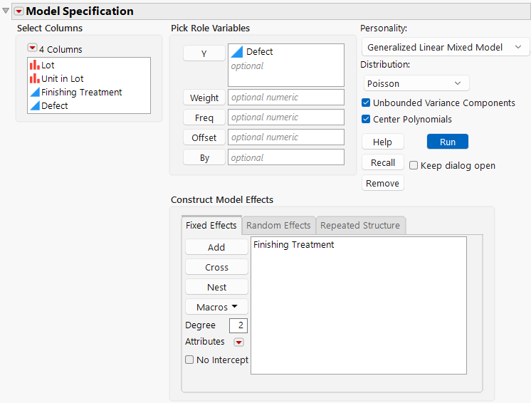

6. Select Finishing Treatment and click Add on the Fixed Effects tab.
Figure 9.9 Completed Fit Model Launch Window That Shows Fixed Effects

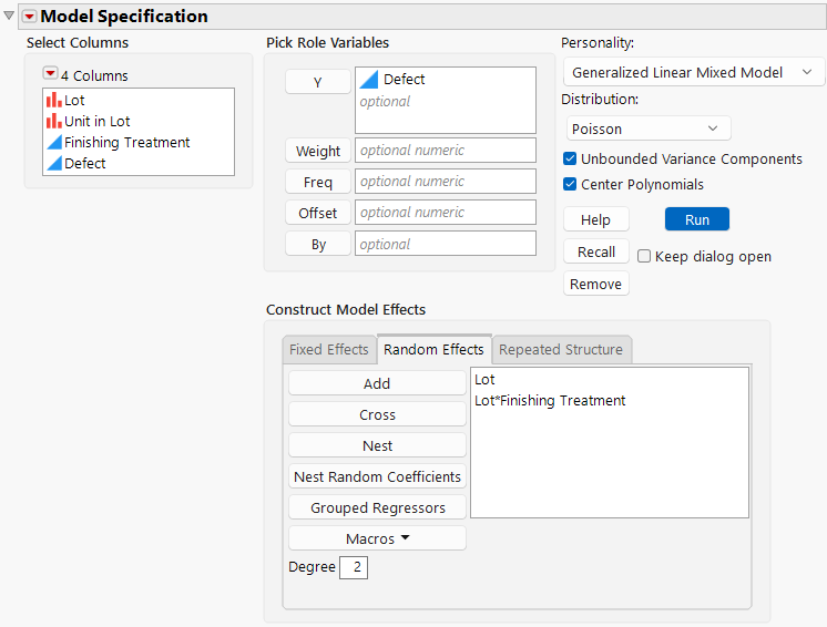

7. Select the Random Effects tab.
8. Select Lot and click Add.
9. Select Finishing Treatment from the Select Columns list, select Lot from the Random Effects tab, and then click Cross.
Figure 9.10 Completed Fit Model Launch Window That Shows Random Effects Tab

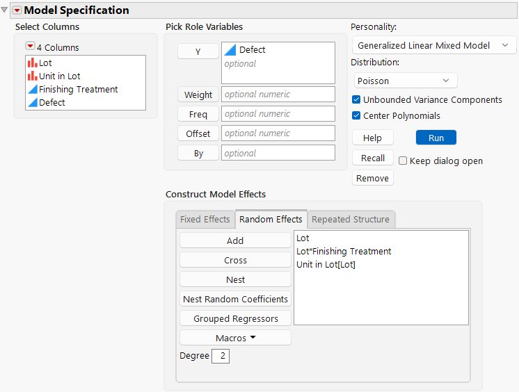

12. Select the Random Effects tab.
13. Select Unit in Lot and click Add.
14. Select Lot from the Select Columns list, select Unit in Lot from the Random Effects tab, and then click Nest.
Figure 9.12 Completed Fit Model Launch Window That Shows Random Effects Tab

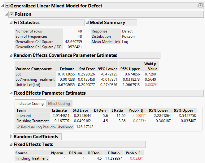

15. Click Run.
Figure 9.13 Generalized Linear Mixed Model Report Window
In the Fit Statistics section of the Generalized Linear Mixed Model report, note that the Generalized Chi-Square / DF statistic is now 1.06. Since this value is close to 1, it is an indication that the overdispersion in the data has been accounted for in the model. Next, you can use this model to determine the level of the finishing treatment that keeps the defect count less than 10.
