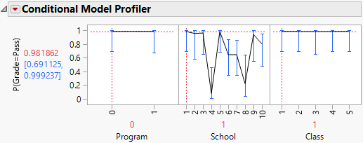

Figure 9.1 Conditional Model Profiler for a Generalized Linear Mixed ModelĀ
