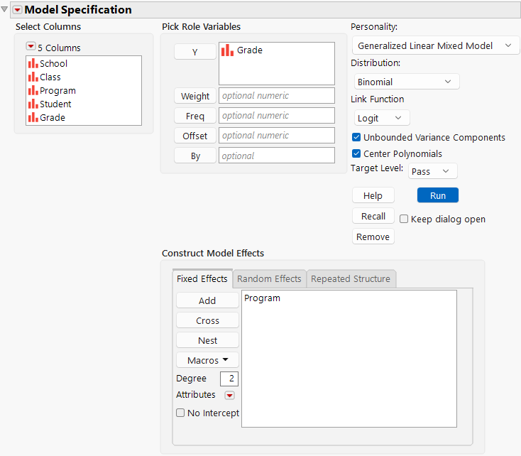

Launch the Generalized Linear Mixed Model personality by selecting Analyze > Fit Model, entering one or more columns for Y, and selecting Generalized Linear Mixed Model from the Personality menu.
Image shown hereFit Model Launch Window
You can specify models with fixed effects, random effects, or a combination of fixed and random effects. You can also specify a distribution for the response variable. The options in the launch window differ based on the nature of the model that you specify. For more information about the options in the Select Columns red triangle menu, see “Column Filter Menu” in Using JMP.
When fitting models using the Generalized Linear Mixed Model personality, you can allow unbounded variance components. This means that variance components that have negative estimates are not reported as zero. This option is selected by default. It should remain selected if you are interested in fixed effects, because bounding the variance estimates at zero leads to bias in the tests for fixed effects. See “Negative Variances” for more information about the Unbounded Variance Components option.
Figure 9.6 Fit Model Launch Window with Generalized Linear Mixed Model Selected
For more information about aspects of the Fit Model window that are common to all personalities, see “Model Specification”. For more information about the options in the Select Columns red triangle menu, see “Column Filter Menu” in Using JMP. Information that is specific to the Generalized Linear Mixed Model personality is presented here.

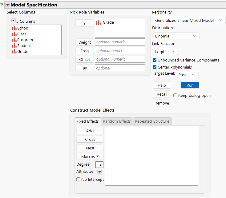

Use the Fixed Effects tab to add fixed effects to the model. Use the Add, Cross, Nest, Macros, and Attributes options as needed. For more information about these options, see “Model Specification”. Note that it is possible to have no fixed effects in the model.
Note: If a continuous column is involved in a random effect and it is involved in an interaction with a categorical effect, the continuous column is not centered, even if the Center Polynomials option in the Model Specifications red triangle menu is selected.
Figure 9.7 Completed Fit Model Launch Window That Shows Fixed Effects

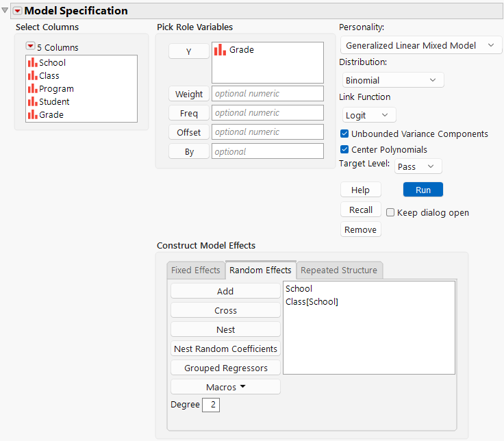

Use the Random Effects tab to specify traditional variance component models and random coefficients models.
Variance Components
For a traditional variance component model, use the Add, Cross, or Nest options to specify terms such as random blocks, whole plot error terms, and subplot error terms. For more information about these options, see “Model Specification”.
Figure 9.8 Completed Fit Model Launch Window That Shows Random Effects

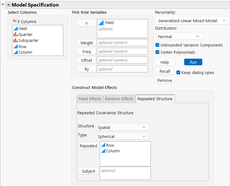

Use the Repeated Structure tab to select a covariance structure for repeated effects in the model.
Table 9.3 Completed Fit Model Launch Window That Shows Repeated Structure Tab
Image shown here
Structure
The repeated structure is set to None by default. The None structure specifies that there is no covariance between observations, namely, the errors are independent. All other covariance structures model covariance between observations.
Table 9.4 lists the covariance structures that are available, the requirements for using each structure, and the number of covariance parameters for the given structure. The number of observation times is denoted by J.
Table 9.4 Repeated Covariance Structure Requirements
Structure
Repeated Column Type
Required Number of Repeated Columns
Subject
Number of Parameters
None
not applicable
0
not applicable
0
Unstructured
categorical
1
required
J(J+1)/2
AR(1)
continuous
1
optional
2
Compound Symmetry
categorical
1
required
2
Toeplitz
categorical
1
required
J
Antedependent
categorical
required
2J-1
Spatial
continuous
2+
optional
If you enter a Repeated or Subject column with the None structure, those columns are ignored. This alert appears: “Repeated columns and subject columns are ignored when the Residual covariance structure is selected.”
Type
When you select the Spatial covariance structure, a Type list appears from which you select a type of spatial structure. Four Types are available: Power, Exponential, Gaussian, and Spherical.
Repeated
Enter columns that define the repeated measures structure. The modeling types of Repeated columns depend on the covariance structure. See Table 9.4 for more information about the requirements for each repeated measures covariance structure.
Subject
Enter one or more columns that define the Subject. Subject columns must be categorical.
