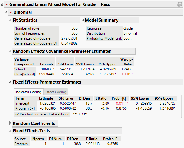

The Generalized Linear Mixed Model report is shown in Figure 9.4. The effect of the teaching program is not statistically significant. However, the class effect nested within school is statistically significant.
Figure 9.4 Generalized Linear Mixed Model Report Window
