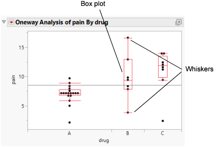

Figure 4.18 Example of Side-by-Side Box Plots

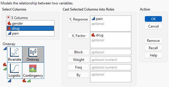

1. Select Help > Sample Data Folder and open Analgesics.jmp.
3. Select pain and click Y, Response.
4. Select drug and click X, Factor.
Figure 4.19 Fit Y by X Window
Fit Y by X Window
5. Click OK.

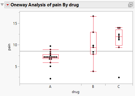

Figure 4.20 Side-by-Side Box Plots

Box plots are designed according to the following principles:
• The line through the box represents the median.
• The middle half of the data is within the box.
• The majority of the data falls between the ends of the whiskers.
• A data point outside the whiskers might be an outlier.
The box plots in Figure 4.20 show these answers:
• There is evidence to believe that patients on drug A feel less pain because the box plot for drug A is lower on the pain scale than the others.
• Drug B appears to have higher variability than drugs A and C because the box plot is taller.
There is one point for drug C that is much lower than the other points for drug C. Hover over the lower point to see that it is row 26 of the data table. That point appears to be more similar to the data in drug groups A or B. The information in row 26 deserves investigation. There might have been a typographical error when the data was recorded.
