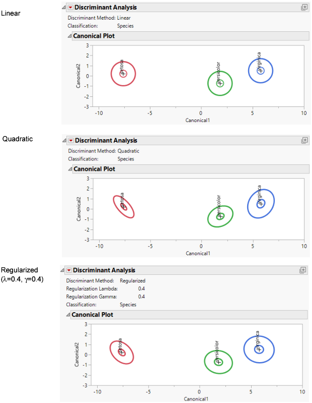

Figure 5.5 Linear, Quadratic, and Regularized Discriminant Analysis
The Linear, Quadratic, and Regularized methods are illustrated in Figure 5.5. The methods are described here briefly. See Statistical Details for Saved Formulas.

Assigning 0 to each of these two parameters is identical to requesting quadratic discriminant analysis. Similarly, assigning 1 to Lambda and 0 to Gamma requests linear discriminant analysis. Use Table 5.1 to help you decide on the regularization. See Figure 5.5 for examples of linear, quadratic, and regularized discriminant analysis.
