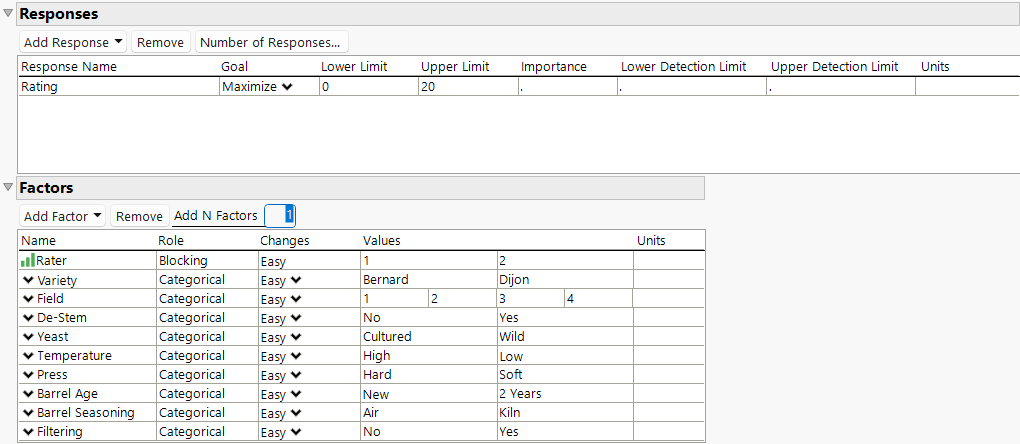

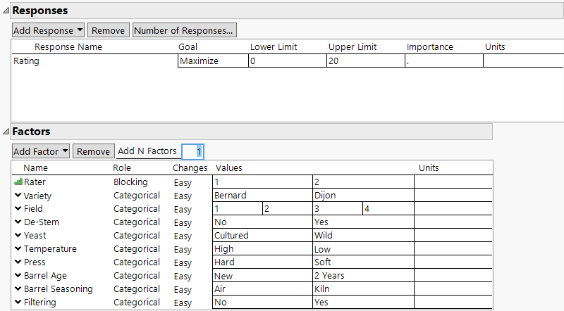

Add Responses
For this custom design example add your response, the response Goal, and, if appropriate, the Lower Limit, Upper Limit, and Importance. Here, the response is Rating.
1. Select DOE > Custom Design.
2. Double-click Y under Response Name and type Rating.
Note that the default Goal is Maximize. Because you want to maximize the taste rating, do not change the goal.
3. Click under Lower Limit and type 0.
The least desirable rating is 0.
4. Click under Upper Limit and type 20.
The most desirable rating is 20.
5. Leave the area under Importance blank.
Because there is only one response, that response is given Importance 1 by default.
Figure 4.2 shows the completed Responses section.
Add Factors
For this custom design example, enter factors manually.
Tip: Once you have entered factors, you can save them to a data table using the Save Factors option. You can load factors from a factors table to populate the Factors.
1. First, add the blocking factor, Rater. Click Add Factor > Blocking > 8 runs per block.
2. Type Rater over the default Name of X1.
Note that Role is set to Blocking. Note also that only one setting for Values appears. This is because the number of blocks cannot be determined until the desired number of runs is specified. Once you specify the Number of Runs in the Design Generation section, the number of levels for Rater updates to what is required.
3. Click Add Factor > Categorical > 2 Level.
4. Type Variety over the default Name of X2.
Note that Role is set to Categorical, as requested, and that Changes is set to Easy by default.
5. Click L1 and L2 and change them to Bernard and Dijon.
6. Click Add Factor > Categorical > 4 Level.
7. Type Field over the default Name of X3.
8. Click L1, L2, L3, and L4, and change them to 1, 2, 3, and 4.
9. Click Add Factor > Categorical > 2 Level.
10. Type De-Stem over the default Name of X4.
11. Click L1 and L2 and change them to No and Yes.
12. Type 6 next to Add N Factors, and then click Add Factor > Categorical > 2 Level. This adds six categorical two-level factors to your design.
13. Change the default factor names and values:
– Yeast (Cultured and Wild)
– Temperature (High and Low)
– Press (Hard and Soft)
– Barrel Age (New and 2 Years)
– Barrel Seasoning (Air and Kiln)
– Filtering (No and Yes)
Note: Use the Units column to enter units for factors or responses. Units are saved as a column property. Detection limits are available only in JMP Pro.
Figure 4.2 Completed Responses and Factors
14. Click Continue.

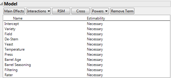

Define the Model
The Model section shows all main effects as Necessary, indicating that the design needs to be capable of estimating all main effects. Your assumed model reflects your interest in main effects only. However, if you wanted to estimate other effects, you could add them to the Model section. For more information about models, see Model.

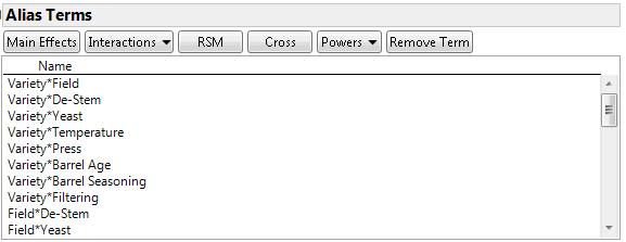

Define Alias Terms
The Alias Terms section specifies the effects to be shown in the Alias Matrix, which appears later. Open the Alias Terms section node to verify that all two-factor interactions are listed. For more information about the alias matrix, see Alias Terms.

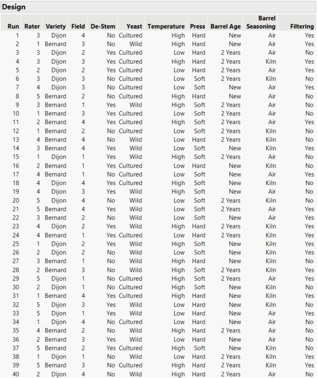

Generate the Design
In the Design Generation section, you can enter additional details about the structure and size of your custom design. In this example, the default design shows 16 runs. But you have five raters, each of whom can sample eight wines. This means that you want a design with 40 runs. Change the number of design runs:
1. Under Number of Runs, type 40 in the User Specified box.
Because you do not want to replicate runs, leave the Number of Replicate Runs set to 0.
2. Click Make Design.
The Design and Design Evaluation sections are added to the Custom Design window. The Output Options panel also appears.

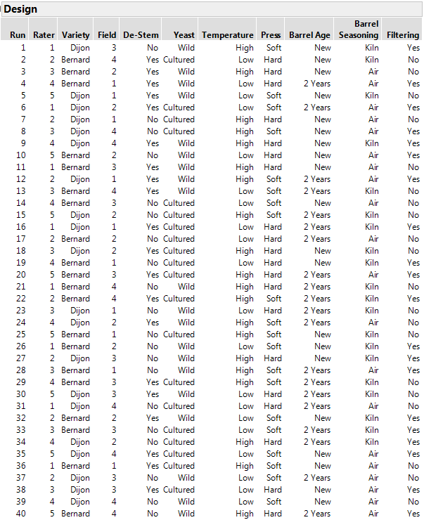

Verify the Design
The Design section shows the runs in the custom design that you have constructed. Later, you are able to randomize the order under Output Options. For now, verify that this design is appropriate for your experiment. For example, check that each of five Raters evaluates eight wines, that all necessary factors are shown, and that none of the settings represent infeasible combinations.
Figure 4.5 Design for Wine Experiment

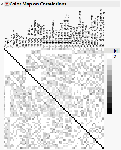

Evaluate the Design

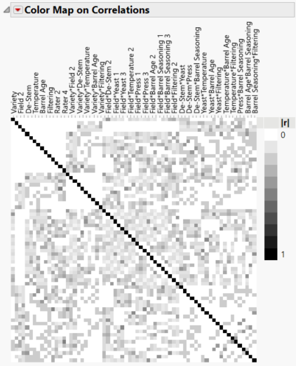

The Design Evaluation section provides different ways to evaluate your custom design. For this example, open the Design Evaluation section, and examine the Color Map on Correlations, the Alias Matrix, and Design Diagnostics. For more information about the Design Evaluation section, see “Evaluate Designs”.
Figure 4.6 Color Map on Correlations
The Color Map on Correlations shows the absolute value of the correlation between any two effects that appear in either the Model or the Alias Terms section. The main effects are represented by the 15 terms in the upper left corner of the map. The white corresponding to the correlations of main effects with other main effects indicate correlations of 0. This means that all main effects are orthogonal and can be estimated independently.
The only black in Figure 4.6 is on the main diagonal. Black indicates absolute correlations of one, reflecting that each term is perfectly correlated with itself. It follows that no main effect is completely confounded with any two-way interaction. In fact, the absolute values of the correlations of main effects with two-way interactions are fairly low. This means that estimates of main effects might be only slightly biased by the presence of active two-way interactions.
Tip: Hover over cells in the color map to see the absolute correlations between effects. Right-click below the legend to save the correlations to a data table.

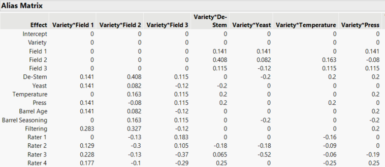

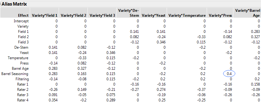

Figure 4.7 Partial View of Alias Matrix
In the Alias Matrix, model effects for your custom design are listed in the column on the left. For a given model effect, a column entry indicates the degree to which the column effect (if active) biases the estimate of the model effect. For example, consider the model effect Barrel Seasoning. If Variety*Press is active, then the expected value of the estimate for the Barrel Seasoning effect differs from an unbiased estimate of that effect. The amount by which it differs is equal to -0.2 times the effect of Variety*Press. Therefore, what appears to be a significant Barrel Seasoning estimated effect could in reality be a significant Variety*Press effect.

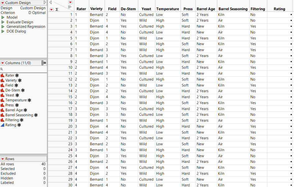

Specify Design Table Options

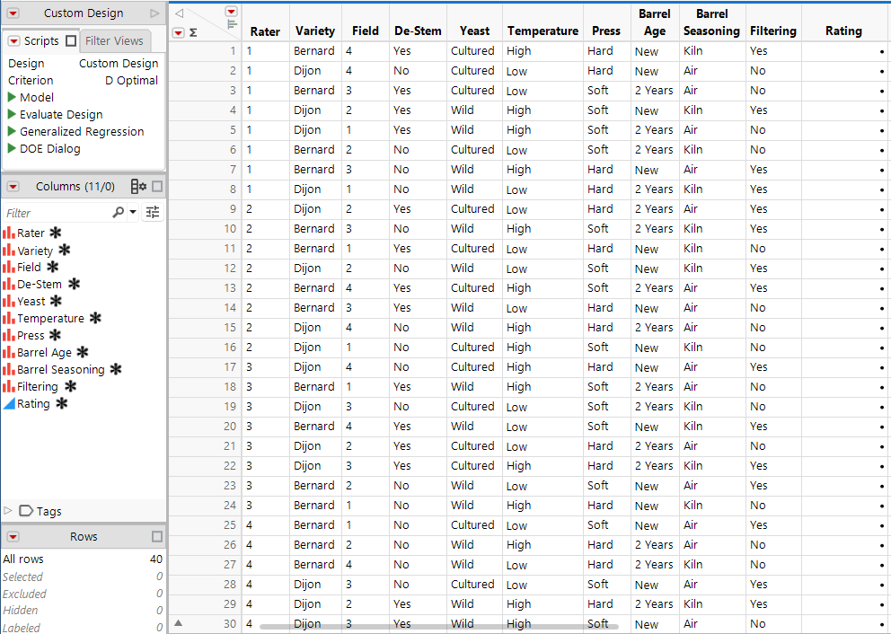

The final steps of your custom design generation are to specify options for the design table and to make the table. Specify the order of runs in your data table using the Output Options panel. The default selection, Randomize within Blocks, is appropriate for this example. Simply click Make Table.
A Custom Design table is created and opens, similar to the one in Figure 4.9.
Note: Your table might look different because the algorithm that creates it uses a random starting design. To obtain the precise table shown in Figure 4.9, set the random seed and number of starts as described in Set Random Seed to Duplicate Design.
Figure 4.9 Partial Custom Design Table
Note the following properties of the design table:
• In the Table panel, the Model, Evaluate Design, and DOE Dialog scripts are added during the design creation process. The Model script opens a Fit Model window containing the effects that you specified as Necessary in the Custom Design window. The DOE Dialog script re-creates the window used to generate the design table.
• In the Columns panel, the asterisks to the right of the factors and response indicate column properties that have been saved to the columns in the data table. These column properties are used in the analysis of the data. For more information about column properties, see Factors and Factor Column Properties.
