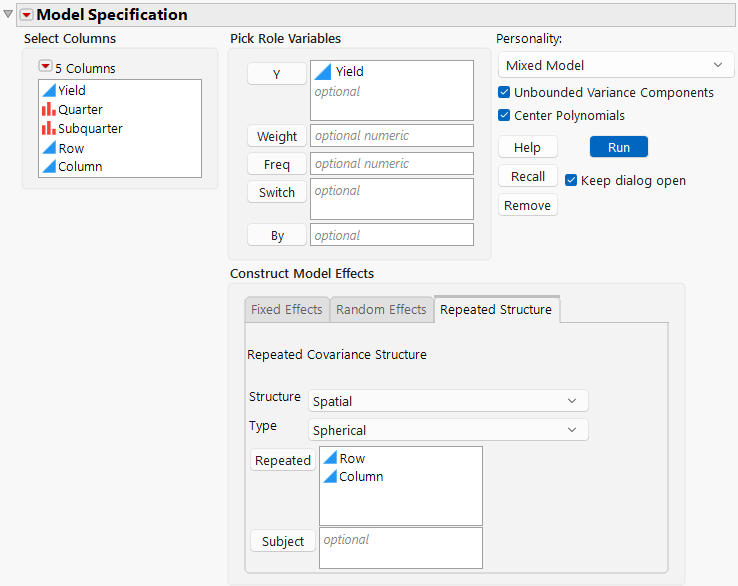

4. Select Yield and click Y.
5. Select Mixed Model from the Personality list.
6. Select the Repeated Structure tab.
7. Choose Spatial from the list next to Structure.
8. Choose Spherical from the list next to Type.
9. Select Row and Column and click Repeated.
Figure 8.33 Completed Fit Model Launch Window That Shows Repeated Structure Tab

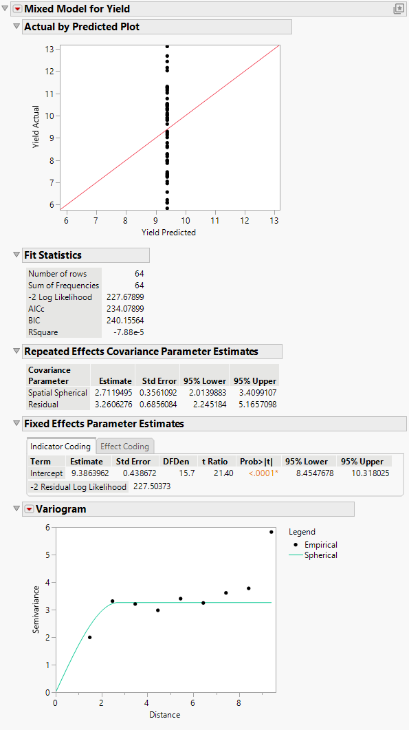

Figure 8.34 Mixed Model Report for Spatial Spherical Covariance Structure
In the Mixed Model report, the Actual by Predicted Plot shows that the predicted yield is a single value. This is because only spatial covariance was fit. The Fit Statistics report shows that -2 Log Likelihood is 227.68, and the AICc is 234.08.
Because an isotropic spatial structure was fit, a Variogram plot is shown. Because the trials are laid out in an 8 by 8 grid, there are more pairs of points at small distances than at very large distances. See Figure 8.38 for the layout. The Variogram shows that a spherical spatial structure is an excellent fit for distances up to about 8.4. The distance class for the final distance consists of only the two diagonal pairs of points.
The Repeated Effects Covariance Parameter Estimates report gives estimates of the range (Spatial Spherical = 2.71) and the sill (Residual = 3.26). See Variogram.

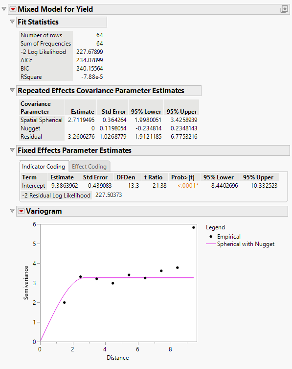

The Mixed Model report is shown in Figure 8.35. Notice that the log-likelihoods are essentially equal to those of the spherical with no nugget model, and the AICc is slightly higher (236.36 compared to 234.08). The Repeated Effects Covariance Parameter Estimates report shows that the Nugget covariance parameter has an estimate of zero. There does not appear to be any evidence for a nugget effect.
Figure 8.35 Mixed Model Report for Spatial Spherical with Nugget

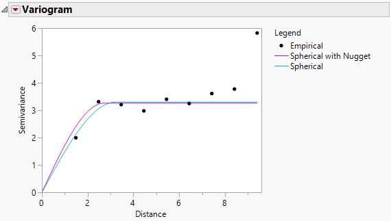

7. Click the Variogram red triangle and select Spatial > Spherical.
Figure 8.36 Variogram in the Mixed Model Report
The two variograms are virtually identical. This also suggests that there is no evidence of a nugget effect.

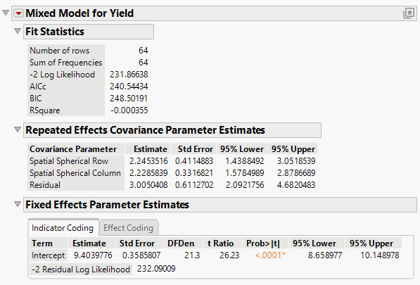

10. To test anisotropicity, select Spatial Anisotropic from the Structure list.
11. Select Spherical from the Type list.
12. Click Run.
The Mixed Model report is shown in Figure 8.37. The fit statistics indicate not as good a fit as the isotropic (spatial structure) spherical model (AICc 240.54 compared to 234.08). The Repeated Effects Covariance Parameter Estimates report shows that the estimates for the Row (Spatial Spherical Row) and Column (Spatial Spherical Column) covariances are very close. There is no evidence to suggest that spatial correlations within rows and columns of the grid differ.

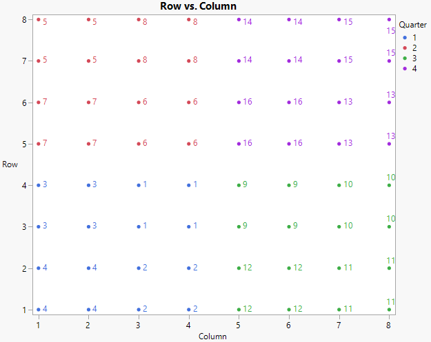

2. In the Tables panel, run the Graph Builder script.
Figure 8.38 Graph Builder Plot of Proposed Complete and Incomplete Block Designs
This plot shows the proposed complete and incomplete block designs for the field. The color indicates the quarter fields that would serve as complete blocks. The numbered points represent the sub-quarter fields that would serve as incomplete blocks.
