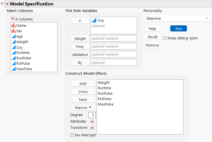

1. Select Help > Sample Data Folder and open Fitness.jmp.
3. Select Oxy and click Y.
4. Select Weight, Runtime, RunPulse, RstPulse, MaxPulse, and click Add.
5. For Personality, select Stepwise.
Figure 5.2 Completed Fit Model Launch Window
Image shown hereValidation is available only in JMP Pro.
6. Click Run.

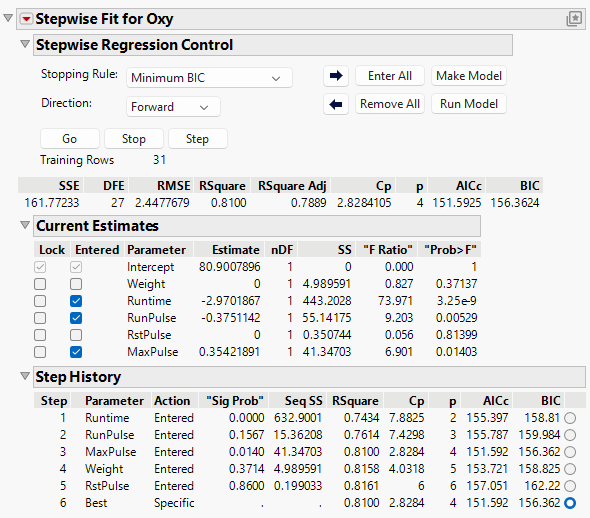

To build a prediction equation for oxygen uptake, use the options in the Stepwise report window to consider models with different combinations of effects.
7. Click Go to use forward selection with a Minimum BIC stopping rule.
Figure 5.3 Completed Forward Selection

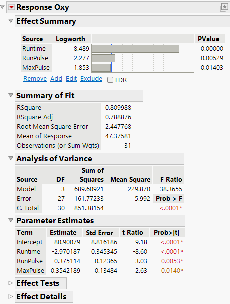

8. Click Run Model.
Figure 5.4 Standard Least Squares Model Report
The stepwise procedure selected three of the five variables to include in the model. Change the variables that are selected in the Stepwise report and then click Run Model to add additional models to the model output for comparison.
