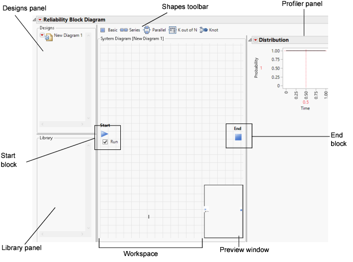

1. Select Analyze > Reliability and Survival > Reliability Block Diagram.
A blank Reliability Block Diagram window appears.
Figure 13.2 New Reliability Block Diagram
Note: The Distribution profiler appears by default.

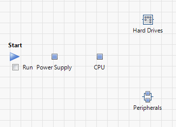

5. Drag a Parallel shape Image shown here to a position to the right and below the CPU shape.
6. Select the label and type Peripherals.
7. Drag a K out of N shape Image shown here to a position to the right and above the CPU shape.
8. Select the label and type Hard Drives.
Figure 13.5 Partial System Diagram

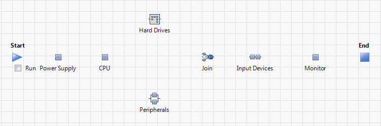

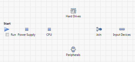

9. Drag a Knot shape Image shown here to the right of the previous shapes.
10. Select the label and type Join.
11. Drag a Series shape Image shown here to a position to the right of the Knot shape.
12. Select the label and type Input Devices.
Figure 13.6 Partial System Diagram
13. Drag a Basic shape to a position to the right of the Input Devices shape.
14. Select the label and type Monitor.
Figure 13.7 System Diagram That Shows All Shapes

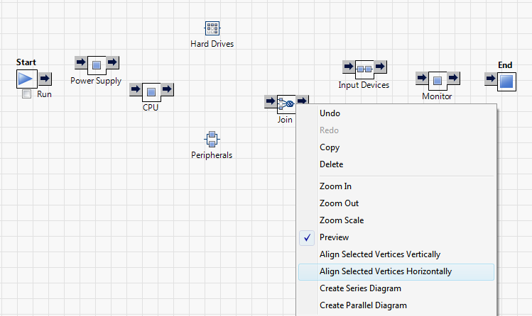

1. To vertically align the shapes for Hard Drives and Peripherals, select the following components:
– Hard Drives
– Peripherals
Tip: To select shapes, drag the cursor around the shapes or press Shift and click each shape.
2. With the shapes selected, right-click one of the shapes and select Align Selected Vertices Vertically.
3. To horizontally align the remaining shapes, select the following components:
– Start
– Power Supply
– CPU
– Join
– Input Devices
– Monitor
– End
4. With the shapes selected, right-click one of the shapes and select Align Selected Vertices Horizontally.
Figure 13.8 Align Shapes Horizontally

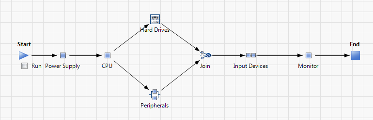

To connect shapes, select a shape to display its connection arrows. Suppose you want to connect shape A to shape B. Select shape A. Drag the right arrow to shape B to indicate that shape A precedes shape B. Drag the left arrow to shape B to indicate that shape B precedes shape A. To connect the shapes in your diagram, select the right arrows to connect to the next shape in the sequence.
1. Select the Start block (blue arrow) to display the connection arrow.
2. Select the single connection arrow Image shown here and drag it to the Power Supply component.
Figure 13.9 Connecting Shapes
Connecting Shapes
3. For each of the following components, click the first component, select its right connection arrow, and drag the arrow to the second component:
1. Power Supply → CPU
2. CPU → Hard Drive
3. CPU → Peripherals
4. Hard Drives → Join
5. Peripherals → Join
6. Join → Input Devices
7. Input Devices → Monitor
8. Monitor → End block
Figure 13.10 Completed System Diagram
