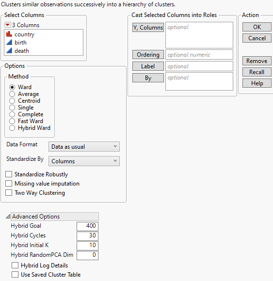

Launch the Hierarchical Cluster platform by selecting Analyze > Clustering > Hierarchical Cluster.
Figure 13.4 Hierarchical Cluster Launch Window
Y, Columns
The variables used for clustering observations.
Ordering
Sorts clusters by their mean values based on the specified column.
Tip: Use the first principal component obtained by conducting a principal components analysis as an Ordering column. The clusters are sorted by these values.

Method
Specifies the method used to calculate distances for defining clusters. For each method, the clusters are joined so that the distance defined by the method is minimized. For distance formulas, see Statistical Details for Distance Methods.

Data Format
Specifies the form of the data that is used in calculating multivariate distances.
Data as usual
Data that are rectangular with one row for each observation and one column for each variable.

Standardize By
Specifies how to standardize the values prior to clustering. This is useful to address the issue of different measurement scales for continuous and ordinal columns.
