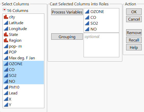

Launch the Manage Limits platform by selecting Analyze > Quality and Process > Manage Limits.
Figure 16.3 Manage Limits Launch Window
Process Variables
The columns of process data containing the measurements. The columns must have a Numeric data type.
Grouping
The columns assigned as grouping variables. You can assign limits or metadata for each process variable at each combination of levels of the grouping variables.
Note: MSA metadata and detection limits cannot vary across group levels. If you import a limits table that contains different values for each process group, only the value of the last grouping level for each process in the limits table is used.
