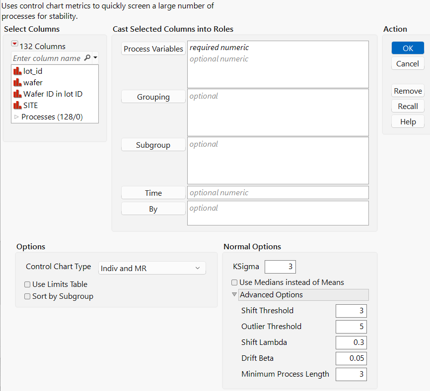

Launch the Process Screening platform by selecting Analyze > Quality and Process > Process Screening.
Figure 8.5 Process Screening Launch Window

Launch Window Options
Options
Provides options that apply to all control chart types.
Control Chart Type
Specifies one of the following control chart types: Indiv and MR (Individual Measurement and Moving Range); XBar and R; XBar and S; XBar, MR, and R; XBar, MR, and S; Count; Nonnegative Continuous; Proportion. The XBar, MR, and R control chart and the XBar, MR, and S control chart are also referred to as three way control charts. The Count, Nonnegative Continuous, and Proportion control charts are non-normal. For more information about statistical details, see “Statistical Details for Control Chart Builder”.

Normal Options
Provides options that apply only to normal control chart types.
Subgroup Sample Size
(Not available when the Control Chart Type is Indiv and MR.) Specifies a constant sample size for subgroups. The minimum subgroup size is 2. A subgroup size of 5 is the default. The Subgroup Sample Size specification is ignored when a subgroup variable is specified.
KSigma
Specifies the sigma multiplier. KSigma is the value that is multiplied by sigma in the calculation of control limits. By default, KSigma is 3.

Advanced Options
Contains the following options:
Shift Threshold
Specifies a value that controls the sensitivity of the Shift Graph. Shift Threshold is set to three by default. After outlier removal, the Shift Graph shows a plot of the time occurrence of all process shifts that exceed the number of within-sigma units specified by the Shift Threshold. See Shift Graph.
Outlier Threshold
Specifies a value that controls the sensitivity of outlier removal for detection of large recent shifts and for the Shift Graph. Outlier Threshold is set to five by default. If the number of within sigma units from an observation to both of its neighboring observations exceeds the specified Outlier Threshold, that observation is replaced with a value that is one within-sigma unit away from its closest neighboring observation. See Shift Magnitudes and Positions.
Shift Lambda
Specifies the weight that is used in the exponentially weighted moving average (EWMA) for shift detection. See Shift Magnitudes and Positions.
Drift Beta
Specifies the weight used in the Holt Double-Exponential Smoother for drift detection. Drift Beta is set to 0.05 by default.
Minimum Process Length
Specifies the minimum number of data values that a process must have in order to be included in the analysis. By default, this value is set to 3.
