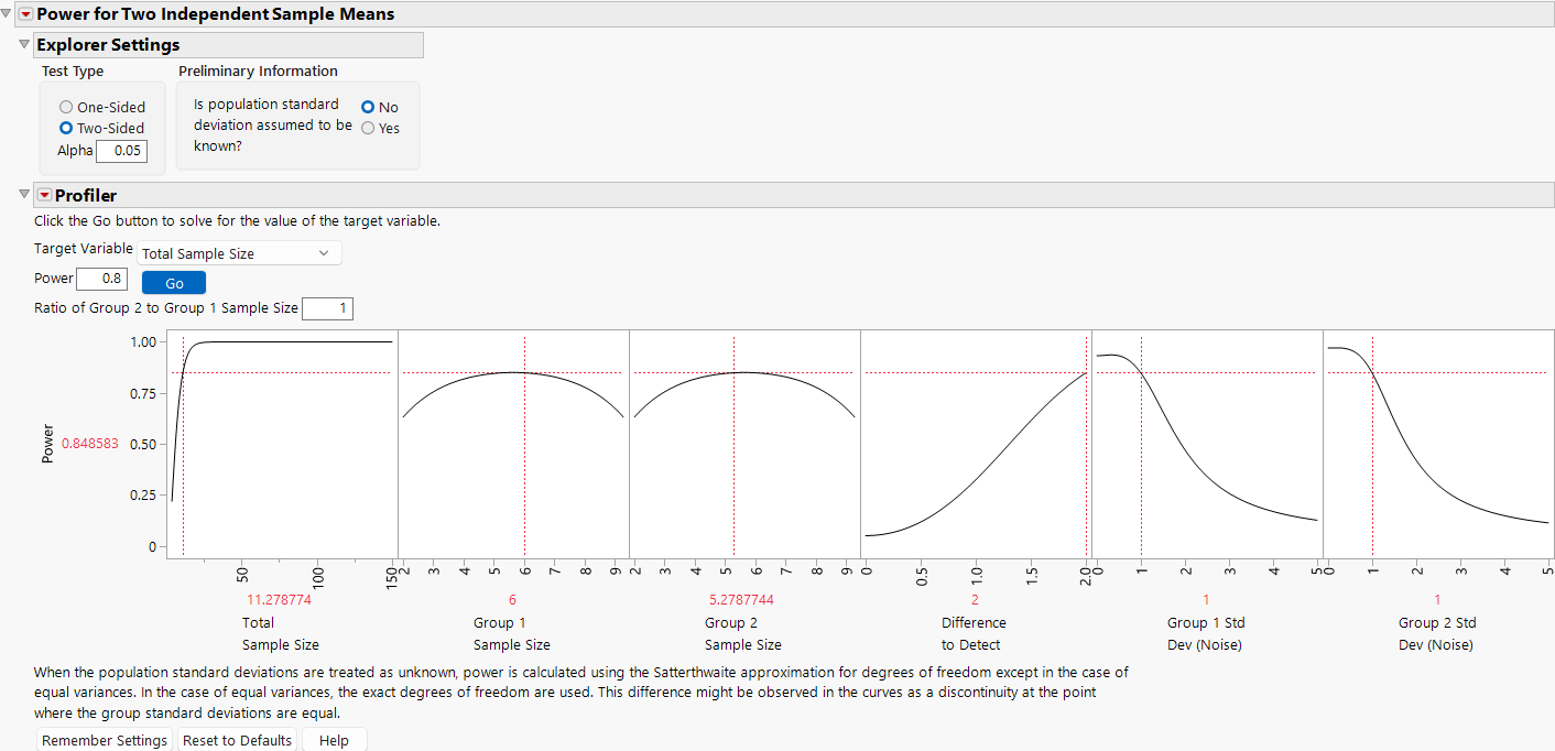

In this example, use the Power Explorer for Two Independent Sample Means to determine the number of units to test in a study of two treatments. Suppose that you are interested in demonstrating that the means of two treatment groups are at least 2 standard deviation units apart. You would like to design an experiment that has 85% power to detect a difference of 2 standard deviation units between the means of the two groups at a significance level of α = 0.05.
1. Select DOE > Sample Size Explorers > Power > Power for Two Independent Sample Means.
2. Leave Test Type set to Two-Sided.
3. Leave Alpha set to 0.05.
4. Leave the population standard deviation assumption set to No. Sample size is calculated using the t distribution.
5. Leave Target Variable set to Total Sample Size.
6. Enter 0.85 for Power.
7. In the profiler, leave the Group 1 Std Dev (Noise) and Group 2 Std Dev (Noise) values set to 1.
8. In the profiler, use the slider or click on the red value for a text box to set the Difference to Detect to 2.
9. Click Go.
Figure 29.4 Two Independent Sample Means Explorer
Note that a sample size is not a whole number. In practice, round the total sample size up to 12 with 6 per group. This results in a power of 0.876, which is above your minimum required power of 0.85.
