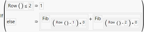

The following formula calculates a column called Fib, which contains the terms of the Fibonacci series (each value is the sum of the two preceding values in the calculated column).
Image shown here
The formula shows the use of subscripts to do recursive calculations. A recursive formula includes the name of the calculated column, subscripted such that it references only previously evaluated rows (rows 1 through (i–1)). The calculation of the Fibonacci series that is shown includes a conditional expression and a comparison. See the sections Conditional Functions and Comparison Functions.
