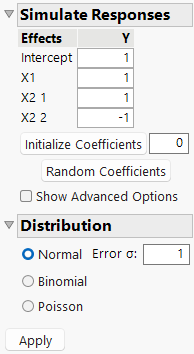

Figure 4.27 shows the Model window for a design with one continuous factor (X1) and one three-level categorical factor (X2). Notice that X2 is represented by two model terms.
Note: For definitive screening designs, the Model window contains a Factors section to enable you to add terms to the simulated model.
Figure 4.27 Simulate Responses Model Window
To specify specific model effects, enter values for the coefficients for each model term and click Apply. Use the Initialize Coefficients button to set all coefficients to the value that you specify in the text box. Use the Random Coefficients button to randomly set coefficients. Click the Apply button to update the simulation.
