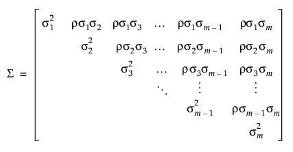

Alternatively, all variance could be modeled on the R-side. Under the Gaussian assumption, this compound-symmetry covariance structure is equivalent to the independence model (Type=CS in SAS). This structure is available in JMP by using the Compound Symmetry structure in the repeated structure tab. Here, the correlation between pairs of repeated observations is the same regardless of the time difference between the observations. Thus, the correlation matrix can be specified as follows:
Equation shown here
Using the Compound Symmetry structure in JMP also assumes a common variance, Equation shown here, among observations taken at any time point. The covariance structure is then Equation shown here where
Equation shown here
and
Equation shown here.
Here, ρ is the intraclass correlation coefficient and Equation shown here is the residual variance. Another option is to use the Compound Symmetry Unequal Variances structure in JMP, which allows the variance to vary across time points. This leads to the following covariance matrix:

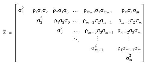

In the Toeplitz structure, observations that are separated by a fixed number of time units have the same correlation. In contrast to the AR(1) correlation structure, the Toeplitz correlations at a fixed time difference are arbitrary. Denote the correlation for observations d units apart by ρd. The correlation matrix is defined as follows:
Equation shown here
The following two options in JMP use this correlation matrix:
• The Toeplitz structure assumes a common variance, σ2, for observations from any time point. The covariance structure is Equation shown here.
• Alternatively, the Toeplitz Unequal Variances structure allows the variance to vary across time points. The covariance structure is defined as follows:
Equation shown here

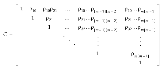

The antedependence model is a general model that is flexible and allows the correlation structure to change over time. In this model, the correlation between two observations at adjacent time points j - 1 and j is unique and is denoted ρj[j−1].
The correlation between pairs of observations at time points j and j′ that are not adjacent is the product of all the adjacent correlations in between.
Equation shown here
For example, the correlation between the pair of observations at time points j=2 and j′=6 would be ρ21ρ32ρ43ρ54.
Equation shown here

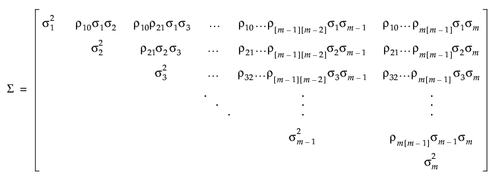

• The Antedependent Equal Variance structure assumes equal variances across observation times while still allowing for the correlations to change. The variance among observations at any time is σ2 and the covariance matrix is Equation shown here.
• The Antedependent structure allows the variance among observations at any given time to vary. Denote the variance among observations taken at time j is Equation shown here. Then the covariance matrix is defined as follows:
Equation shown here
