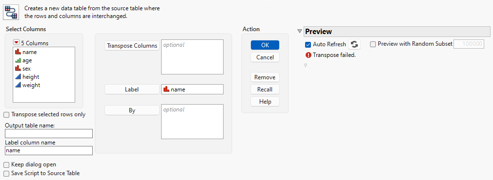

Figure 6.13 Transpose Window
Transpose Window
3. Highlight the column names that you want to transpose in the Select Columns box.
4. Click Transpose Columns.
5. (Optional) Customize your transposed table further by using the additional options.
6. Click OK.
Transpose Options
Select Columns Filter Menu
Contains options to search and filter through columns. See “Column Filter Menu”.
Transpose selected rows only
Transposes only rows that are currently highlighted in the active table.
Output table name
(Optional) Specifies the name of the subset table.
Label column name
(Applicable only if you have specified a Label column) Specifies an alternative name for the Label column. Otherwise, the default column name is Label.
Keep dialog open
Keeps the Transpose window open after you click OK.
Save Script to Source Table
Saves a script to the original data table that enables you to transpose the data again by using the same settings.
Transpose Columns
Adds the columns that you want to transpose.
Label
Uses the data from a column in the original table as the column names in the new table. Follow these steps:
1. Highlight a column from the Select Columns box.
2. Click Label. The column name appears in the Label box.
The default column name is Label. You can specify an alternative name for the column by using the Label column name option. Only one column is created for each distinct value in the label column. Therefore, if there are duplicate values in the label column, JMP creates only one column for the duplicated value by using the value from the last duplicated row.
By
Organizes the transposed columns into groups that are based on the columns that you put into the By box. Follow these steps:
1. Highlight the column names in the Select Columns box whose values you want to see as a group.
2. Click By.
Auto Refresh
Automatically refreshes the table Preview. If the Preview takes too much time to complete, you can deselect this option and click the Refresh button Image shown here. This option is selected by default.
Preview with Random Subset
Select this option for very large tables that can cause delays as the Preview panel is refreshed. This option is deselected by default.
