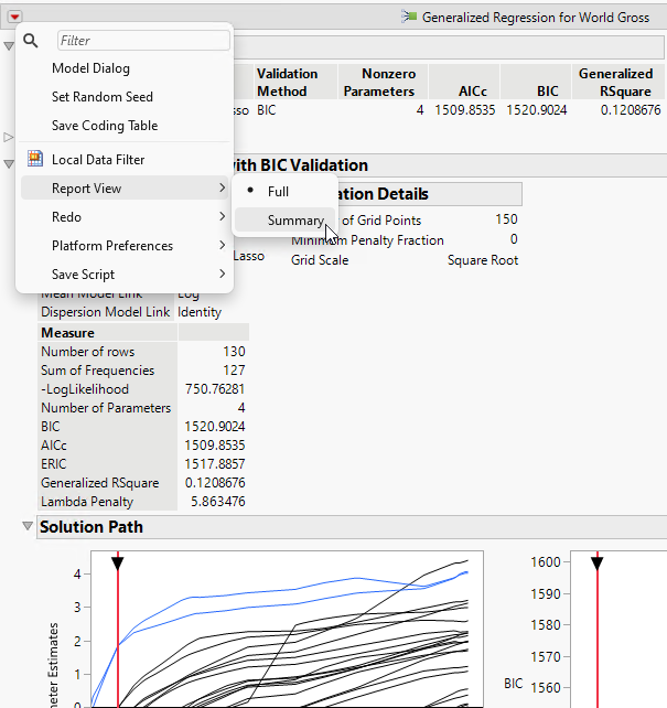

View a Report Summary
A report that contains graphs and statistics can grow fairly large. To view only the graphs while running the report, select the top red triangle in a report and then select Report View > Summary. The report shown in Figure 12.8 originally showed parameter estimates. In the Summary view, only the graphs are shown.
Figure 12.8 Viewing a Summary of the Report

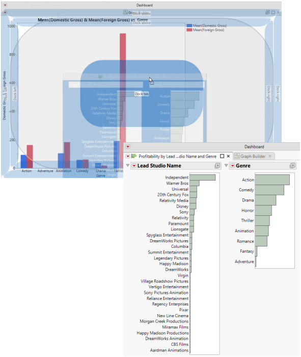

Rearrange Reports in a Running Dashboard
You rearrange reports in a running dashboard by dragging the reports into highlighted drop zones. The drop zones indicate where you can place the report. Figure 12.9 shows an example of moving a report into a tab. The Distribution report is dropped inside the “Dock tab” drop zone to place it on the first tab.
Figure 12.9 Creating Tabbed Reports in a Running Dashboard
To remove a tabbed report, click the middle of the report and drag it outside of the tab.

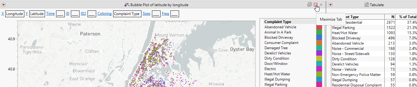

Maximize a Report in a Running Dashboard
To see only a specific report while running a dashboard, select the report’s Maximize Tab box.
Figure 12.10 Maximizing a Tab
Maximizing a Tab

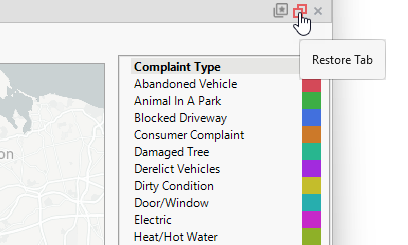

To restore the report to its original size, select the Restore Tab box.
Figure 12.11 Restoring a Maximized Report

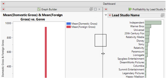

Resize Reports in a Running Dashboard
The thick gray line that appears between reports in a dashboard is called a splitter. Drag the splitter to resize the panels. When the panel is too wide to display the enclosed report, the panel closes. Drag the splitter from the outer edge of the dashboard to see all reports again. Figure 12.12 shows the collapsed and expanded reports.
Figure 12.12 Resizing panels in a Running Dashboard
You can also drag the edge of a graph. The graph widens as far as the width of the window and the other reports allow.
