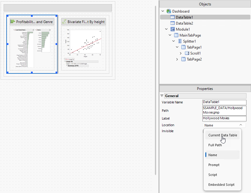

To Change the Location of the Data Table
After you assign the location of the data table (current data table or name), you can change the setting in the dashboard Objects and Properties panels.
1. Click the Dashboard Builder red triangle and select Show Properties.
Figure 12.19 The Objects and Properties Panels
2. In the Objects panel, select DataTable1.
3. In the Properties panel, use the drop-down list to change the Location, as shown in Figure 12.19.
For example, if you change the Name location to Current Data Table, the selected graph on the dashboard is based on the current data table.
Note: The Location value of Current Data Table applies only when you are running the dashboard. When you are editing the dashboard, Dashboard Builder uses the full path to locate the data table.
