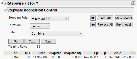

Stepwise Regression Control Panel
Use the Stepwise Regression Control panel to limit regressor effect probabilities, determine the method of selecting effects, begin or stop the selection process, and run a model. A list of the number of rows that are used in the model building appears beneath the Go button. The list includes the count of training, test, and validation rows, if appropriate. The list also includes the count of excluded or missing rows.
Figure 5.6 Stepwise Regression Control Panel
