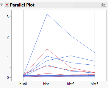

A parallel plot is one of the few types of coordinate plots that show any number of variables in one plot. However, the relationships between variables might be evident in the following circumstances only:
• When the variables are side by side
• If you assign a color to a level of a variable to track groups
• If you select lines to track groups
Note: To produce the plot that is shown in Figure 7.5, follow the instructions in Example of a Parallel Plot.
Figure 7.5 The Parallel Plot Report
