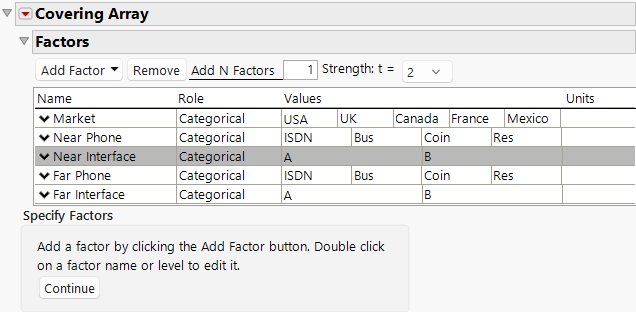

Notice that the menu next to Strength: t = , is set to 2 by default.
3. Click the Covering Array red triangle and select Load Factors.
The Factors section is populated with the five factors and their levels.

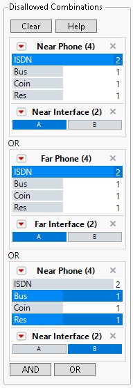

1. Select Use Disallowed Combinations Filter.
2. From the Add Filter Factors list, select Near Phone and Near Interface and click the Add button.
3. Press Ctrl and click ISDN under Near Phone and A under Near Interface.
Figure 20.12 Disallowed Combinations Panel That Shows First Constraints
Both blocks should turn dark. You have added the constraint that an ISDN line on the originating phone (Near) cannot use interface A.
4. Click OR.
5. From the Add Filter Factors list, select Far Phone and Far Interface and click the Add button.
6. Press Ctrl and click ISDN under Far Phone and A under Far Interface.
You have added the constraint that an ISDN line on the receiving phone (Far) cannot use interface A.
7. Click OR.
8. From the Add Filter Factors list, select Near Phone and Near Interface and click the Add button.
9. Press Ctrl and click Bus and Res under Near Phone and B under Near Interface.
You have added the restriction that Business and Residential lines on the originating phone (Near) cannot use interface B.
Figure 20.13 Completed Disallowed Combinations Filter

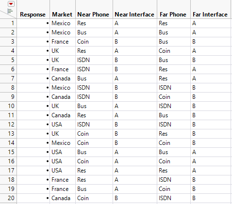

4. Click Make Table.
The design is placed in a design table. A column for the response is provided, as well as various scripts.
Figure 20.16 Covering Array Design Table

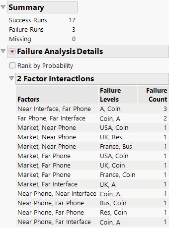

Figure 20.17 Analysis of Phone Experimental Data
The Summary section indicates that three tests failed.
The Failure Analysis Details section contains a 2 Factor Interactions report, because a two-way interaction is the lowest level interaction that detects a failure.
The 2 Factor Interactions report shows the combinations that might have caused the three failures. It is possible that one combination, Near Interface set to A and Far Phone set to Coin, is responsible for all three failures. Or it is possible that two or three other combinations caused the three failures.
3. Select the first line in the 2 Factor Interactions report.
In the data table, rows 4, 16, and 19 are selected. Failures occur for these combinations, regardless of the settings for Market, Near Phone, and Far Interface. But note that other combinations of factor settings could account for these failures as well.
